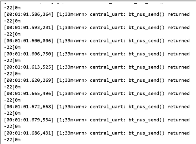

    You figured out that bt_nus_send() returns something other than 0, since you are checking the value. But can you please check what it returns?
    int err;
    err = bt_nus_send(conn, data, len);
    if (err) {
        LOG_WRN("bt_nus_send() returned %d", err);
    return err;

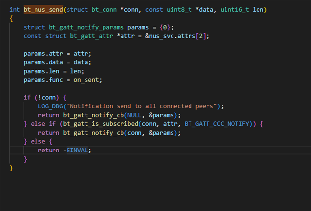

  • I was wondering if “data” is empty, does that cause “bt_nus_send()” to fail?
    If bt_nus_send() returns -22, it means EINVAL.
    It probably means that your conn pointer is invalid. Please note how the peripheral_uart sample stores the current_conn pointer in the connected event (and that it invalidates it in the disconnected event). That current_conn parameter is one that you could enter into bt_nus_send().

    "default_conn" should be equal to "current_conn" that can be entered into bt_nus_send(). But in this case, my phone can't connect to that DK when it's already connected to another DK. In addition, bt_nus_send failed either.
    So I was wondering, do I need two variables to represent the two different devices the DK connected to?
    Looking for your answer!
    Yes, you do. Aslo note that as a central, the API is different than from the peripheral. if you are a peripheral (connected to a central), you should use bt_nus_send(), as it does in the peripheral_uart sample. If you are the central in the connection (and you are connected to a peripheral), you should use the API bt_nus_client_send(), as it is used in the central_uart sample.
    And again, yes, you need two different conn handles. One for the central and one for the peripheral.
