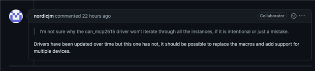

  • Hello Simon,
    below, the response from the contributor; would you help me understand how to try to modify and / or replace macros?
    Thank you and
    Best Regards
    Drivers have been updated over time but this one has not, it should be possible to replace the macros and add support for multiple devices.
