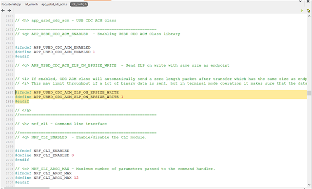

    In your sdk_config.h, can you try to set "#define APP_USBD_CDC_ACM_ZLP_ON_EPSIZE_WRITE 1" and see if this helps as well?
    Håkon
  • That flag is already enabled:
    Also I have deleted all the logs inside the event handler and print the Rx buffer in the main but it still does not work:
