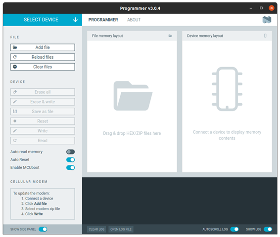

  • Thanks for your insight.
    You must use the bootloader to upload the firmware without erasing, for example putting the device in bootloader mode and using the Programmer app with "Enable MCUboot" selected, using MCUmgr, or using OTA if you have support for that on your device.
    Which programmer app uses the "Enable MCUBoot" option?
    Is it possible to put the device into bootloader mode and send the updated firmware via serial connection? For example, I have an LPC Microcontroller on my board and would like to send firmware to it, and it then sends the new firmware via serial connection to my nRF5340 on the same board.
    Alex
  • Hi Alex,
    The Programmer app in nRF Connect for Desktop:
    See nRF Connect for Desktop for download and nRF Connect Programmer for information on how to use it.
    Yes, this should be possible. You can use another chip as SMP client as long as the chip supports SMP or can implement it. See mcumgr and SMP for some more information about SMP. A colleague of mine has made a sample where another nRF chip is acting as SMP client, see Bluetooth: Central SMP Client DFU. If the chip is supported in nRF Connect SDK or Zephyr you can use this sample as a starting point. If it is not supported, you will have to implement the SMP client yourself. For this you can try and have a look at SMP Protocol Specification.
    Marte
