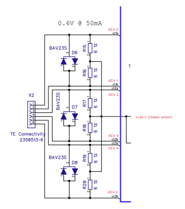

We are using a custom nRF9160 board with 3 differential ADC channels. The differential voltage is measured across two resistors, with the center voltage (normally OpAmp driven) at 1,66 V.

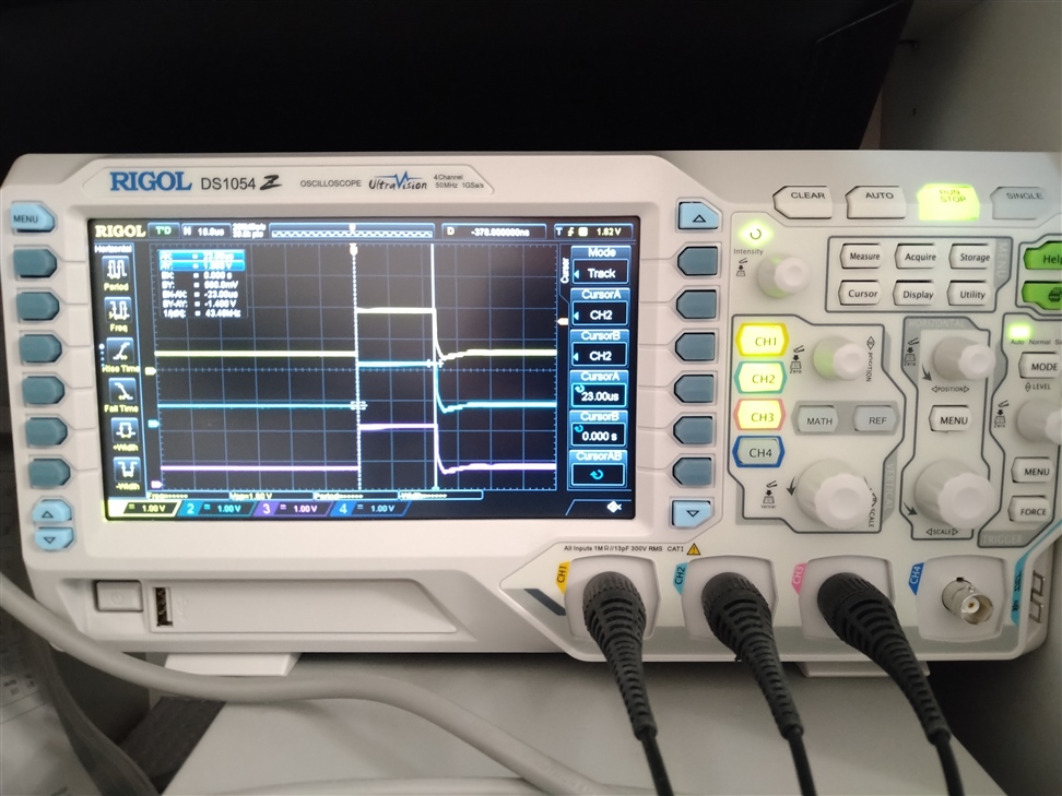

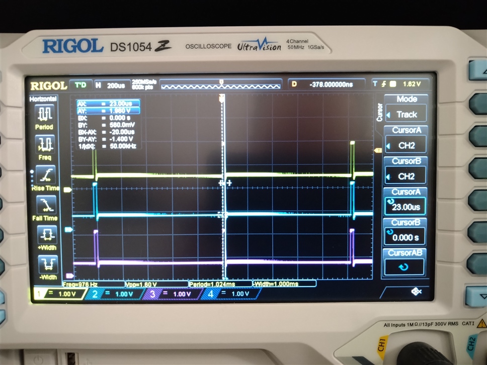

I'm sampling three ADC channels in differential mode and noticed weird results and verified with a scope: Taking a sample with more than one channel enabled results in nRF9160 connecting the ADC-inputs to what appears to be VDD-ish for a period that seems to be TACQ*2. Sampling is triggered by PPI, currently at 1 kHz, and this phenomenon happens at every sample. (Changing the PPI frequency changes the spike positions as well.
Changing to single-ended measurement makes no difference but the problem doesn't show on scope with only one channel enabled.
Do I have something wrong with my SAADC configuration?
UPDATE 2022-10-24: Issue is related to CONFIG_BOOTLOADER_MCUBOOT and pin P0.14, which seems to configured as output and connecting to VDD_GPIO when it is sampling ADC

Scope images (OpAmp off, resulting in ~0,7 V average at the OpAmp output)

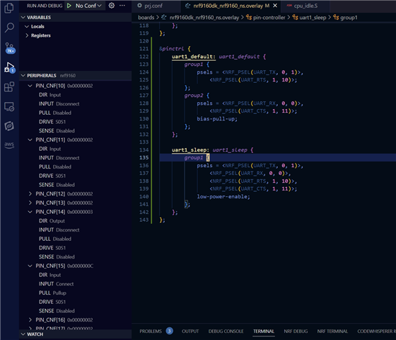

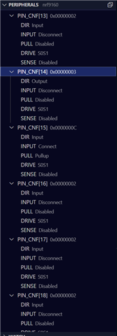

  • Ok, feels like it's at least partly solved for now. With the debugger I found that the PIN_CNF -registers were not identical for AIN0 - AIN5, and the P0.14 was configured as Output.
    Setting the PIN_CNF -regs manually and the problem is gone...
    static void set_pin_cnf(uint8_t pin) {
      NRF_P0_NS->PIN_CNF[pin] =
          (GPIO_PIN_CNF_DIR_Input         << GPIO_PIN_CNF_DIR_Pos)
        ||(GPIO_PIN_CNF_INPUT_Connect     << GPIO_PIN_CNF_INPUT_Pos)
        ||(GPIO_PIN_CNF_PULL_Disabled     << GPIO_PIN_CNF_PULL_Pos)
        ||(GPIO_PIN_CNF_DRIVE_S0S1        << GPIO_PIN_CNF_DRIVE_Pos)
        ||(GPIO_PIN_CNF_SENSE_Disabled    << GPIO_PIN_CNF_SENSE_Pos);
    I still don't know why exactly this is the case, as no other part of the code touches GPIO, UART1 is disabled and there's nothing in the devicetree about P0.14.

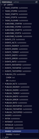

  • Hello again,
    Thank you for your patience with this.
    Since you are building for Non-secure, you will have TF-M added, which in turn uses UART1 for logging from the secure application, which is likely why you are seeing this behavior in your application.
    JyriLehtinen said:
    Where exactly should I be looking at, or even better, what would be the best method of finding such definitions?
    If you check the devicetree in Visual Studio code for your application, does UART1 have the okey status? This is a quick way to check whether the UART1 instance is enabled.
    Karl
