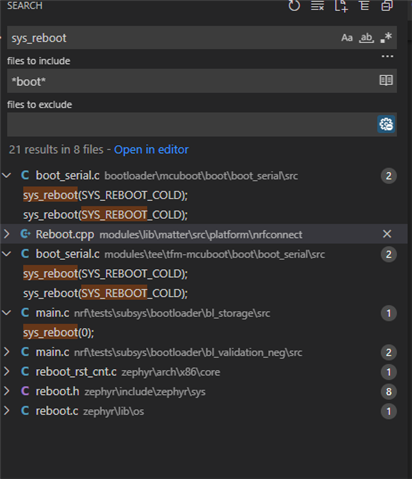

    2.Once the upgrade is done the reset is initiated automatically right where this is handled in the code so that we will reser ourself
    please search for sys_reboot() in the mcuboot code to find the soft resets that are applied in the code. In my search it looks something like this.

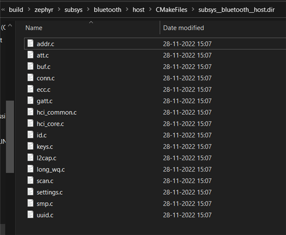

    6. when Firmware is sent over BLE , which part of the code is involved in keeping in falsh and loding. because we want to understand and based on that we want to add one file which we need to use later for sending it over SPI to other module. can you please pint out the code which is handling this stuff.
