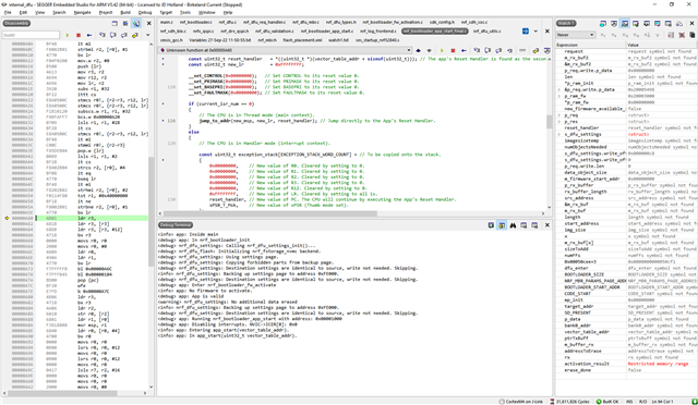

I  used the nRF52840 SDK 15.3.0 dfu secure_bootloader uart example to develop a custom bootloader. I have checked that my application file is correct by trying it without the bootloader.  I have also validated that the soft device and application files match what they are expected after a successful DFU.
After the bootloader determines that the app is valid, it proceeds through nrf_bootloader_app_start.c and nrf_bootloader_app_start_final.c but after
jump_to_addr(new_msp, new_lr, reset_handler); // Jump directly to the App's Reset Handler.
the firmware doesn't start the application.
Any ideas why the firmware breakpoint stops at the address in MBR 0xA60 4B01 ldr r3 after the jump and doesn't start the application?
watch1.txt attached is the watch of s_dfu_settings and vector_table_addr immediately before the jump.

Here's app_start:
/**@brief Function for booting an app as if the chip was reset.
 * @param[in]  vector_table_addr  The address of the app's vector table.
__STATIC_INLINE void app_start(uint32_t vector_table_addr)
    NRF_LOG_INFO("In app_start(uint32_t vector_table_addr).");
    const uint32_t current_isr_num = (__get_IPSR() & IPSR_ISR_Msk);
    //const uint32_t new_msp         = *((uint32_t *)(vector_table_addr));                    // The app's Stack Pointer is found as the first word of the vector table.
    const uint32_t new_msp         = ((uint32_t *)(vector_table_addr));                    // The app's Stack Pointer is found as the first word of the vector table.
    const uint32_t reset_handler   = *((uint32_t *)(vector_table_addr + sizeof(uint32_t))); // The app's Reset Handler is found as the second word of the vector table.
    const uint32_t new_lr          = 0xFFFFFFFF;
    __set_CONTROL(0x00000000);   // Set CONTROL to its reset value 0.
    __set_PRIMASK(0x00000000);   // Set PRIMASK to its reset value 0.
    __set_BASEPRI(0x00000000);   // Set BASEPRI to its reset value 0.
    __set_FAULTMASK(0x00000000); // Set FAULTMASK to its reset value 0.
    if (current_isr_num == 0)
        // The CPU is in Thread mode (main context).
