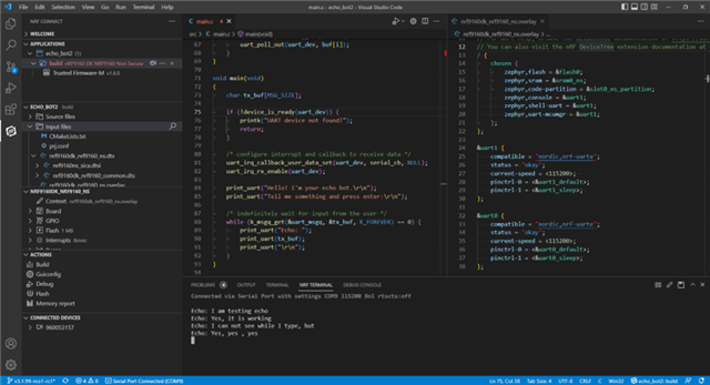

  • Hi Hassan Khan,
    I am attaching complete project folder in the zip format. Once you unzip and analyze files, you will see that I have only included the overlay file. Rest of the project is exactly same.
    echo_bot2.zip

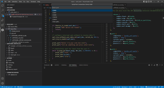

    Another thing is connecting to the right COM port with correct baudrate / configuration. I am also attaching snapshots of connecting to COM port using nRF terminal, and the sample output of the project after it has been flashed on the DK and COM port is connected to the terminal output.
    Two things to note here is that: (1) you will not see any output if you are connected to wrong port or with wrong configurations, and (2) if everything is correct, and you start typing in the terminal, you will not see characters as you type in, but rather you will see the echo back (the same message) from the echo-bot on DK once you press ENTER key.
    I hope it will be helpful.
    With regards,
    Naeem
