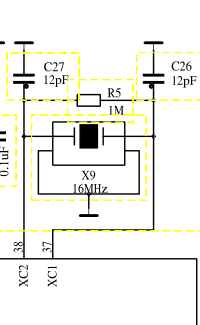

schematics(only antenna part) image description

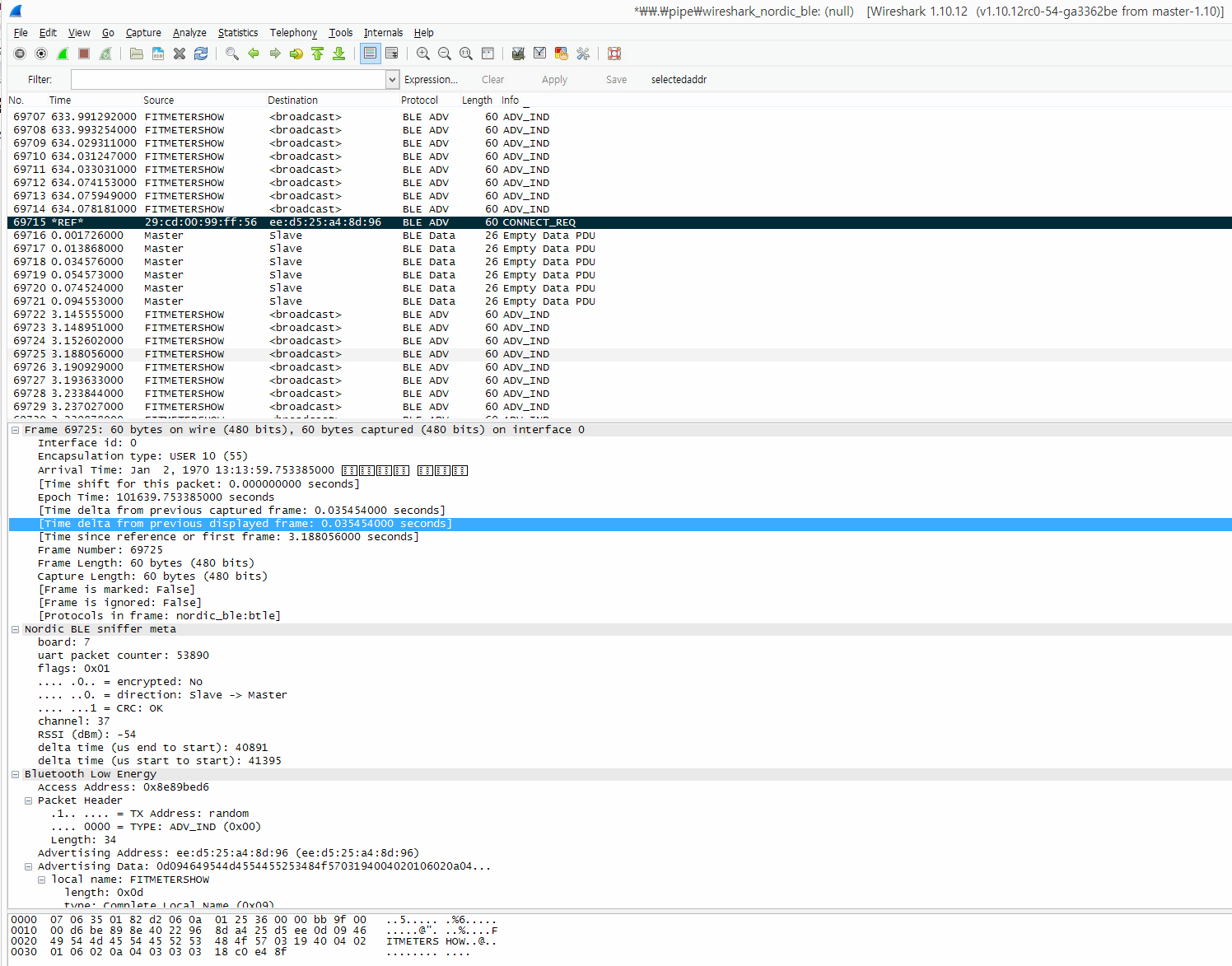

I attachment packet sniffer data.
sniffer data
sniffer data is contains adv packet with channel 37, 38, 39. but not scan_req by smartphone.

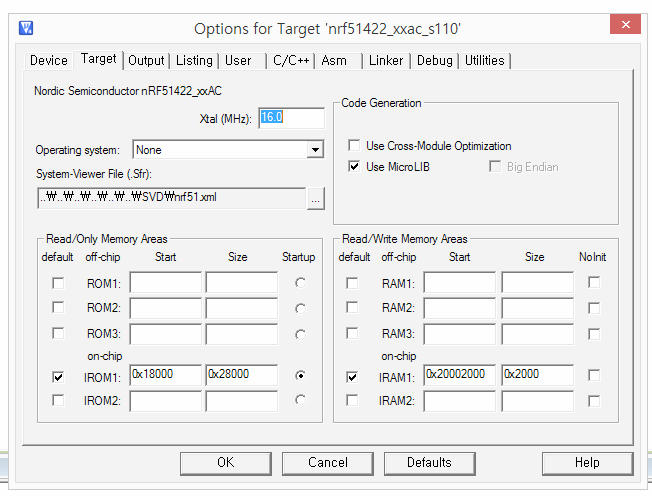

#Add1 project option change for ram size(16kB ram) image description
nrf sniffer and wireshark image description

    Your rev 3 chip is with 16kB RAM, you may need to modify the project setting of the SDK examples because they were made for the nRF51422 QFAC which has 32kB RAM.

    And I already change example project. ram size to 16kB(0x6000 -> 0x2000) in keil project option(Read/Write memory areas). please refer upper add image in post.

  • @wooseok: Could you capture again a trace that has the following:
    • You device advertises
    • MCP on PC get connected (with the dongle)
    • Disconnect MCP on PC, then use nRF MCP on Android to try to connect
    After that, in Wireshark, click File -> Save and save the trace as .pcapng file. There is more information in the pcapng than the .txt file.
    I suspecting there could be something wrong with the 32kHz crystal. Could you send me the BOM of your board, also layout if possible. Could you send me the source code of the project you are testing with, it could be the SDK's example that you modified to test on your board ?
