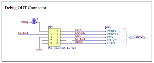

The one of our customers recently purchased NRF52-DK (Dev. Kit) which was Ver 2.1.0.
But This time has issue.
He thinks after
version 3.0.0. cause the problem.
It seems like more switches were added and IC sized different than Version 2.1.0 2021.35 which normally working.
So, the questions are,
*He requires the information what's the differences between those models and how to make it work Version 3.0.0?
Can you give us some advice?

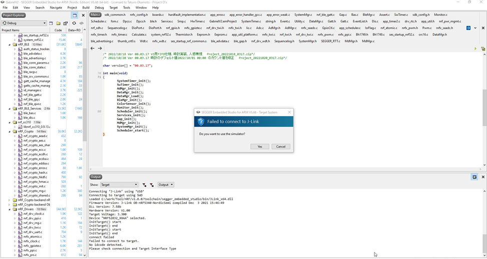

    SEGGER Embedded Studio (SES) is still usable with the newer nRF52 DKs, as the new debugger also has J-Link firmware compatible with SES, so there shouldn't be a problem there. Since it seems like you're trying to debug and program an external board, do you also have the same issues when only trying to use the DK by itself and the onboard nRF52 SoC? Also, can you share some information on what voltage the external board is supplied with, and whether it is an nRF device on board or not?
    However, it's worth noting that we're now focusing on the nRF Connect Extension for VS Code if your customer is working on the nRF Connect SDK and not the nRF5 SDK.

     " do you also have the same issues when only trying to use the DK by itself and the onboard nRF52 SoC? Also, can you share some information on what voltage the external board is supplied with, and whether it is an nRF device on board or not?"
    >The customer still checking use the DK by itself and the onboard nRF52 SoC.
    But voltage the external board is supplied with, and whether it is an nRF device on board is 3.00V DC stabilized power supply.
    I will get back as soon as checking DK can run and the onboard nRF52 SoC
