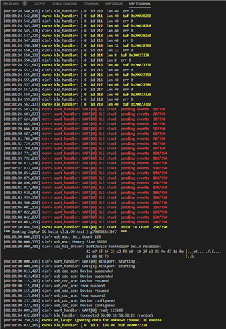

Notice how inside the system work queue bt_send_work_handler, a warning is printed before the bt_nus_send call, followed by an info message. This is used to track when bt_nus_send is entered and exit. In the trace there is an enter event at 24.562,133, which is not followed by an exit event. At this moment, the system work queue is blocked by bt_nus_send, and as a result event handlers are no longer called to free slab buffers and continue normal communication. The following error messages indicate that the synthetic test continues to queue events with data to be sent, and when 250 events are queued, the system reboots. With the test disabled, the UART task will starve for slab buffers and stop. If the BLE client disconnects, normal operation is restored.
