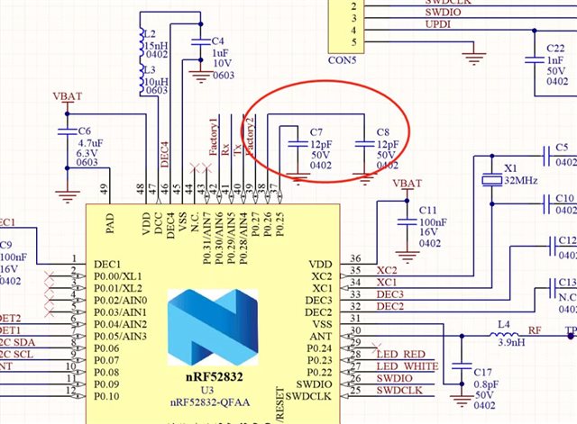

customer 52832 product had problem that they can't pass fcc test,the reason for this is they forgot to add capacity to those pins.
their design is:
and our refrence design is:
also we had errata to clarify about this.
now my question is , Is there any way to solve this by software instead of adding capacity, cause it is pre-production period, not easy to change the hardware right now.
