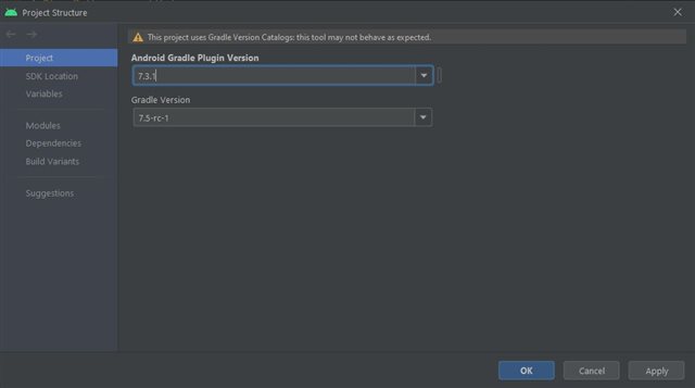

  • I switched to
    Android-nRF-Toolbox-3.1.3
    Android-BLE-Library-2.4.1
    Android-Common-Libraries-1.0.13
    according to settings.gradle file
    But now I have gradle sync issues.
    class com.android.tools.idea.gradle.project.sync.ModelCacheV2ImplKt$modelCacheV2Impl$1 cannot be cast to class com.android.tools.idea.gradle.project.sync.ModelCache$V1 (com.android.tools.idea.gradle.project.sync.ModelCacheV2ImplKt$modelCacheV2Impl$1 and com.android.tools.idea.gradle.project.sync.ModelCache$V1 are in unnamed module of loader org.gradle.internal.classloader.VisitableURLClassLoader @4fe9985b)
    Gradle's dependency cache may be corrupt (this sometimes occurs after a network connection timeout.)
    Re-download dependencies and sync project (requires network)
    The state of a Gradle build process (daemon) may be corrupt. Stopping all Gradle daemons may solve this problem.
    Stop Gradle build processes (requires restart)
    Your project may be using a third-party plugin which is not compatible with the other plugins in the project or the version of Gradle requested by the project.
    In the case of corrupt Gradle processes, you can also try closing the IDE and then killing all Java processes.
    What must Android Gradle Plugin version and Gradle version be in the project structure?
  • Those you can use matching your current Android Studio version. I guess it's 7.3.1 now I'm Chipmunk. Just the common library dependency should be left to 1.0.13, other can be set to meet ones.
