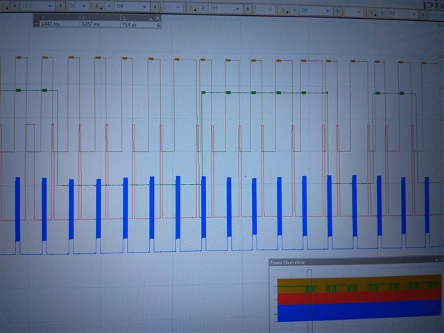

    this is how i set my timer and what i actually see in the picoscop6 is that i have the 'timer_spi_xfer' event which is timed ok (via ppi) but the interrupt handler called by ch2 compare event seems to be late sometimes .. how can i find why and maybe improve it without going to 'DIRECT' ?
    the red line up at beginning of irq handler and down at the end, it can be seen that sometimse it raises closer to the blue lines start (sp_xfer), any idea what can cause this ?
    The execution of the handler will depend on other interrupts and priority of the tasks in your application. If this handler is high priority, you should try to increase its priority.
    The PPI signals are handled purely in HW, and are not affected by CPU usage by other tasks.
    Likely some other higher/equal priority task in the application is blocking the execution of the handler.
