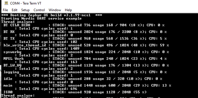

  • tried now with
    CONFIG_THREAD_ANALYZER=y
    CONFIG_THREAD_ANALYZER_USE_PRINTK=y
    #CONFIG_THREAD_ANALYZER_AUTO=y
    #CONFIG_THREAD_ANALYZER_AUTO_INTERVAL=5
    CONFIG_THREAD_STACK_INFO=y
    CONFIG_THREAD_NAME=y
    CONFIG_THREAD_RUNTIME_STATS=y
    CONFIG_THREAD_MONITOR=n
    changed the ble_write_thread to below in peripheral_uart example
    void ble_write_thread(void)
    	/* Don't go any further until BLE is initialized */
    	k_sem_take(&ble_init_ok, K_FOREVER);
    	for (;;) {
    		// Run the thread analyzer and prints the output in standard form.
            thread_analyzer_print();
    		/* Wait indefinitely for data to be sent over bluetooth */
    		struct uart_data_t *buf = k_fifo_get(&fifo_uart_rx_data,
    						     K_FOREVER);
    		if (bt_nus_send(NULL, buf->data, buf->len)) {
    			LOG_WRN("Failed to send data over BLE connection");
    		k_free(buf);
    and get the stats when I press new line character in the serial terminal
    This means that the feature is working as it should and the auto refresh thing is disabled.
    I do not know what your setup is but have you tested this in the peripheral_uart (or any other sample) other than your setup?
    It seems like the errors you are seeing have some conflicting structs definitions of the thread analyzer which I am not able to reproduce.
