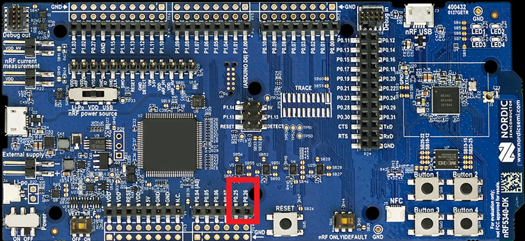

I'm trying to do something extremely simple but can't get it to work. Through the dev academy, I successfully loaded up and executed exercise 1. However, when I then try to "Create a New Application" (rather than "Add and existing appliction), running the exact same main.c code, I am not able to toggle the LEDs and none of the GPIOs seem to be configured. I'm guessing this has something to do with the generated files, but I don't know where to start looking. Please help!
BTW - I am able to attach with the debugger and see that the initialization seems to be completing without error and function call to the gpio toggle also returns with no error. main.c code for both applications is the following:

  • I've gotten a little closer to the root of the problem but still need some help. Looking at the registers for the pin, with the application that can successfully toggle the LED, I see this:
    With the application that cannot, I see this:
    So somehow the pin control is being assigned to the network core, not the application core. I verified that for both projects, the build configuration is the same (UBX_EVKNORAB10_NRF5340 Application MCU). So what project settings assign pins to the different cores and how do I set that up? In my application, at least for now, I have no need for the Network MCU to control pins directly, so all should be assigned to the Application core.
    Jamie

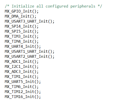

    2) Using STM32 applications as an example, in their main files we get something like the following:
    So each of these HAL functions is called from main which makes it very easy to jump into the generated code and see exactly what registers are being set, etc, to configure a peripheral. In Zephyr code, this seems to be very obfuscated. Where are the initialization calls taking place since?
    3) In STM32 applications, we also get an assembly file - e.g. startup_stm32h743zitx.s - which, upon reset, initializes all the memory then jumps to main. Where does this occur in Zephyr?
    The reset code is implemented in /zephyr/arch/arm/core/aarch32/cortex_m/reset.S, which in turn calls the z_arm_prep_c() function in /zephyr/arch/arm/core/aarch32/prep_c.c, which among other things call the z_cstart() function in init.c that I mentioned earlier.
