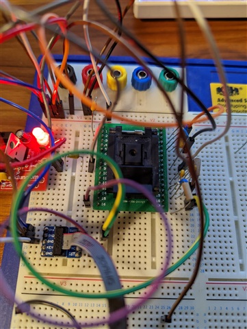

I've put the recommended circuit for the nRF52810 QCAA chip together on breadboard (schematic is below) and am using a J-Link Edu Mini to program.
I created a custom board template in nRF Connect with nrf52810 QFAA (no QCAA option) and used it to build both Hello World and Blinky examples. When I try to flash either example I receive a "ERROR: Write verify failed." message which expands to:

    The board is messy unfortunately but here's an image:
    The VDD pins all show roughly 3.3V, DEC1 shows 1.1V and DEC2 shows 1.3V.
    I've double checked the capacitor on DEC1 and it is definitely 100nF so I'm not sure why it is at 1.1V.

    Running the chip from a socket like this, with all the external components hooked up on a breadboard, is more or less guaranteed to fail unfortunately.
    The long connections between the pads on the chip and the components will add a lot of capacitance to the signals, which will affect the operation of the device.
    Is your end goal to make your own PCB?
    If so I would recommend getting an nRF52DK for development.
    The nRF52DK uses the nRF52832 rather than the nRF52810, but we don't have a dedicated DK for the nRF52810. When developing your code it is possible to limit the project to the resources of the nRF52810, even if the nRF52832 is used for development.
    If your end goal is just to run something from a breadboard I would look for an nRF52810 module that has the right pitch and placement of GPIO's so that it can be connected to the breadboard easily. For a full list of 3rd party modules using the nRF52810 please have a look here

  • That...makes perfect sense now that you mention it.
    My end goal is to make a PCB but I had the idea to fully prototype it first to aviod any issues with the final design. I can see why that isn't an option now though.
    I have had the nRF52DK for a while now so I will just use that instead.
    I really appreciate youir help Torbjørn, thanks a lot.
