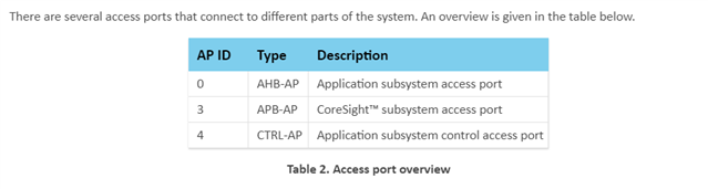

And then I try to write the value to "ERASEPROTECT->DISABLE" as the same c-code using this script.
setPassword.txt
SWDSelect
SWDWriteDP 1 0x50000000
SWDWriteDP 2 0x04000010
SWDWriteAP 3 0xDEADBEEF
sleep 10000
SWDWriteDP 2 0x04000000
SWDWriteAP 0 0x00000001
SWDReadAP 0
SWDReadAP 0
sleep 5000
SWDWriteAP 0 0x00000000
SWDReadAP 0
SWDReadAP 0
sleep 1000
exit
Command to run script
$ JLinkExe -Commandfile setPassword.jlink
The result:

I found my board can't disable erase protection and I can't recover it.

  • Hi
    The issue was solved, I made a mistake by putting ERASEPROTECT.LOCK enable state and setting key to ERASEPROTECT.DISABLE.
            while (NRF_NVMC->READY == NVMC_READY_READY_Busy);
            if (NRF_UICR_S->ERASEPROTECT != UICR_ERASEPROTECT_PALL_Unprotected)
                    NRF_CTRL_AP_PERI_S->ERASEPROTECT.LOCK = (uint32_t)0x00000001;
                NRF_CTRL_AP_PERI_S->ERASEPROTECT.DISABLE = key;
    Doing this locked out the device before setting the erase protect key. which in turn makes the device unrecoverable. it was clearly discussed here https://devzone.nordicsemi.com/f/nordic-q-a/100614/request-for-guidance-and-documentation-on-eraseprotect-approtect-secureapprotect
