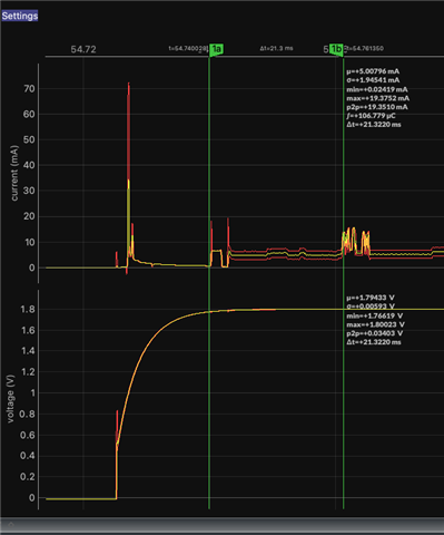

High Current 400ms+ Startup Delay BLE Beacon Using RC Oscillator
Setup:
- VS Code - NRF Connect v 2.1.0
- Hardware: NRF52840-DK  @ 1.8V

I have disabled the LFXTAL and enabled the RC Oscillator as the clock source to reduce startup time, however from cold boot I am seeing a ~430ms period of inactivity that is running @ 4mA.

Any idea why the default NCS/Zephyr implementation for the BLE Beacon has this 400+ms delay before any BLE beacons are sent and why its at ~4mA?
Is there some additional KConfig setting I need to change?
  • Yes!
    This was it, thank you.
    From cold boot @1.8V to first Beacon transmission it takes 20ms. This is still a little higher than I was hoping for, but I can work with this.
    One last question - this 20ms period is at @4mA. Which I don't believe is the case for the NRF5 SDK implementation. So maybe some more room for startup time improvement or maybe that is the time it takes for Zephyr and the BLE stack to initialize?
    This is good enough for me. Thank you for your help!
