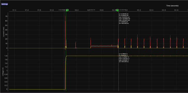

I have disabled the LFXTAL and enabled the RC Oscillator as the clock source to reduce startup time, however from cold boot I am seeing a ~430ms period of inactivity that is running @ 4mA.
power consumption

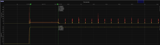

If I change my clock settings back to use the XTAL then another 400ms (expected) period is added for a total of 800ms of no BLE activity:
current consumption with xtal
Yes I have powered cycled after programming. Yes I have performed a Pristine build.

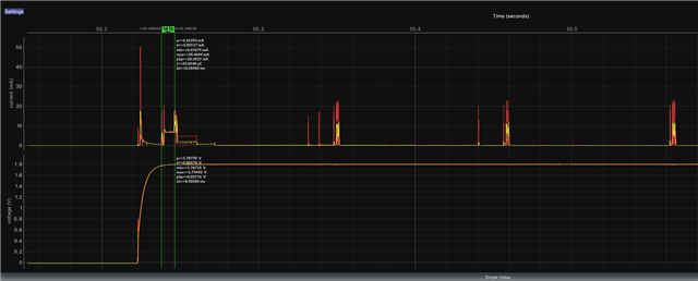

When I load up the same BLE Beacon firmware from NRF5 SDK with the same clock settings, I DO NOT see this 400+ms delay. This looks to be specific to NCS/Zephyr.
Screenshot of NRF5 SDK sample code with RC oscillator as soft device clock:
nrf5 sdk no delay

Any idea why the default NCS/Zephyr implementation for the BLE Beacon has this 400+ms delay before any BLE beacons are sent and why its at ~4mA?
Is there some additional KConfig setting I need to change?
  • I tseems like cc3xx initialization is causing this delay but I need to understand more on the default settings in nRF5SDK and NCS. It looks like CC3xx is enabled by default in newer SDK and seems like it was not the case in older SDK. But before I say anything concrete, let me do some internal investigation.
  • It seems like in NCS when using BLE cc3xx is enabled by default in the config and we have seen in other case that this is the root cause for the startup delay. So we need to focus on disabling this if you can use internal RNG instead of cc3xx. What errors are you getting when you try to disable CC3XX?
