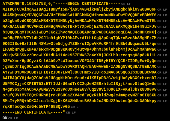

I want to update the AWS certificate for Device from CLI at time of Production.
They files including Amazon root Certificate ,Client Cert and Private key are in PEM format. I am using at Wrapper for using AT commands in Zephyr Shell. I am unable to paste the whole certificate in shell due to multiline format of file.
so I removed carriage return and new line character from certs files and make it only single line text in file.
now if I  want use the files as a cert files its not working ,I am not able provision the device.
I am using following AT commands from Zephyr shell at AT%CMNG.
Is there any way that I  give path of text file in this command.
or any other alternative for Device Provisioning other then LTE link monitor terminal.

    This mean \r \n part of cert format.
    Is there any way to Paste the whole cert in Zephyr CLI(Shell).
    if I paste the whole cert without removing \r \n CLI treat new line as new command.
    as I see we can paste the whole cert in LTE link terminal and its work.

  • We are dealing with a similar issue. We are able to write the certificates/keys if we use the clear AT command (not running from within the shell). Once we enable the shell, the shell processing messes things up.
    I am wondering if the command: at at_cmd_mode would help to start it up in AT mode only. I looks to me that's why this mode was created in the first place.
    We haven't yet moved forward to the newer versions of the SDK but this might provide enough reasons to move forward.
    Anybody have thoughts on this?
