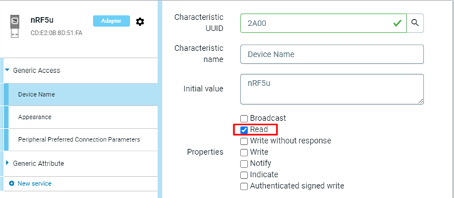

I need to configure server parameters in the "Bluetooth Low Energy Standalone v4.0.0" PC application used with nRF52840 dongle.
I configured Device Name as Read only:
saved, applied to the device and started advertiisements. It is displayed as Read only:

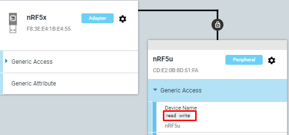

But when scanning such configured nRF52840 dongle using BTool from Texas Intsruments it shows the name is Read Write intead of Read only:
I verified it with second nRF52840 dongle and the result is the same - Read Write instead of Read only:
Is there any bug in the "Bluetooth Low Energy Standalone v4.0.0" or I am doing something wrong?
