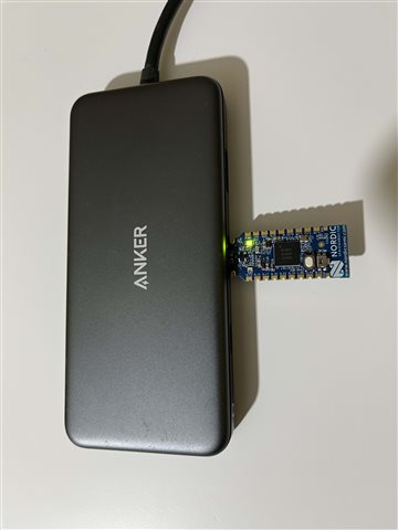

My nRF52840 dongle which was working fine in the past doesn't seem to be responding properly.  Is there anything I can do?
Some background:
1 - I have used it in the past and it worked fine.  I upgraded the OS on my Mac and a few months later I tried to use the dongle and WireShark couldn't see it.  Pressing the reset button doesn't seem to do anything.
2 - In a terminal I can see this so the dongle is alive
            nRF Sniffer for Bluetooth LE:
              Product ID: 0x522a
              Vendor ID: 0x1915  (Nordic Semiconductor ASA)
              Version: 2.03
              Serial Number: C16B484007400E7A
              Speed: Up to 12 Mb/s
              Manufacturer: ZEPHYR
              Location ID: 0x14410000 / 3
              Current Available (mA): 500
              Current Required (mA): 100
              Extra Operating Current (mA): 0
3 - If I open the nRF Programmer and select my dongle I see this

4 - If I open the nRF Connect For Desktop app I see this message but the green light does come on

    In your 3 &4 log, it said that installed JLink version does not match the provided version
    19:41:32.584 Using JLink version: JLink_V7.82
    19:41:32.635 Installed JLink version does not match the provided version (V7.66a)
    19:43:41.720 Using JLink version: JLink_V7.82
    19:43:41.769 Installed JLink version does not match the provided version (V7.58b)
    Try other JLink version like V7.58b or V7.66a. Or you can install by the latest version of nRF-Command-Line-Tools.
    Amanda H.
  • Hi - I installed V7.66a of JLink and tried the programmer again
    It's much the same issues.  Any ideas what to do next?  I never see the red light come on.
