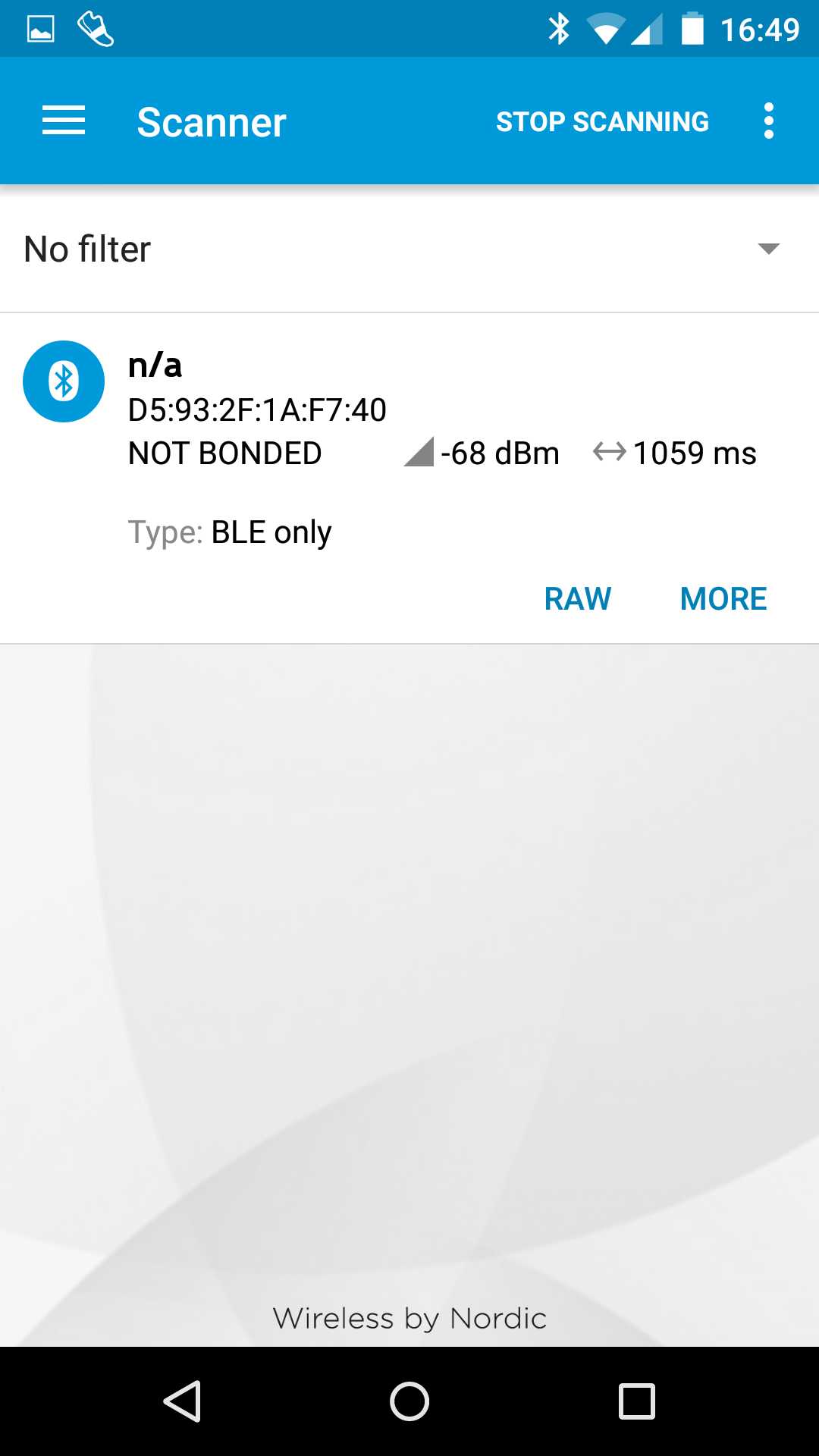

I'm testing the DFU as described in this link developer.nordicsemi.com/.../a00086.html after reseting in DFU mode, when I start the device discovery, I only get empty packets

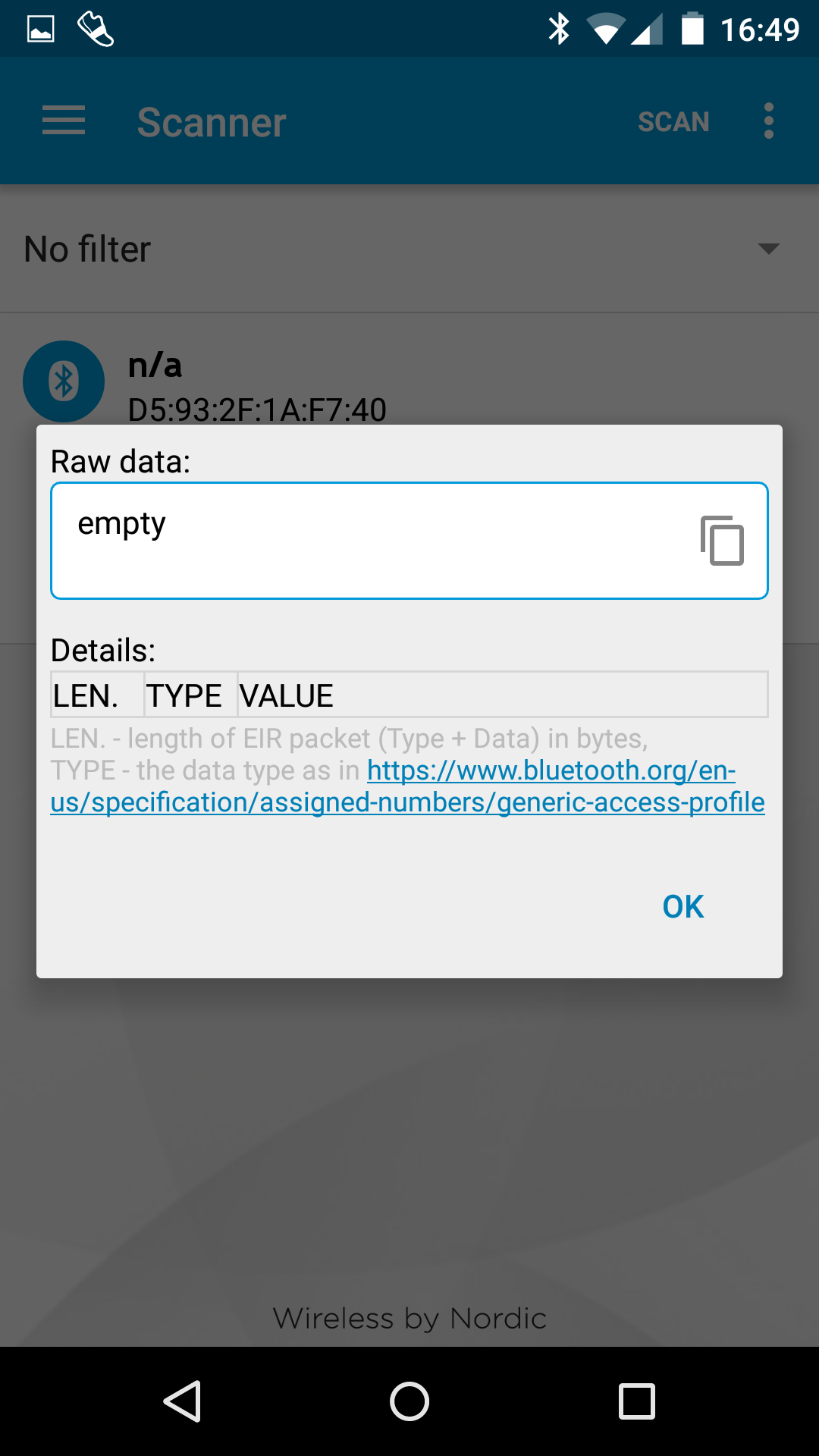

but what I want to do is to reset the device in bootloader mode without using the button on the board as described in this link Testing the example without bonding I did all the steps as described but in step 10 10.Verify that the device is now advertising as "DfuTarg". I get the empty packet
You mean if you hold a button and reset the chip you can enter bootloader and can do DFU, but when you do button-less, you only have the device advertise with no data at all ?
This is pretty strange. Could you zip your bootloader project and the application project and add them into your question ? A sniffer trace could be very useful.
yes exactly with the button it works fine. I can also update the firmware from the service in the hrs example. but I can't get it back to the bootloader advertising as "DfuTarg" from the service.
