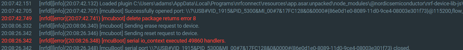

I have activated the verbose mode on Windows nRF programmer Desktop and I have been able to catch these error messages:

    1: nRf programmer v3.0.4 logs two errors in verbose mode, "delete package returns error 8" and "serial io_contect executed 49860 handlers" (see original post for screenshots) while it still tells me the flashing of the thingy53 has been successfull.
    Where can I find the documentation presenting those errors ?

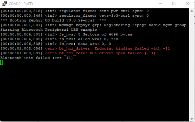

    2: The only app that seems to do something after I flash it with nRF programmer is the peripheral_uart app, the LED lights up in white and I get those messages on the COM port:
    So two errors about bt_hci_driver and bt_hci_core.
    Again, is there some documentation detailing those erros ?
