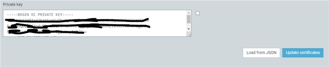

After that we flashed the board with the at_client demo and loaded the certificates and key to the modem as described here, using the LTE Link Monitor.
Set modem to "offline" (AT+CFUN=4)
copy BaltimoreCyberTrustRoot.crt.pem into "CA certificate";
copy "devicename"-public.pem into "Client certificate";
copy "devicename"-private.pem into "Private key";
As "Security tag, we used 10, like the defaul in the Kconfig
With these settings, we  update the certificates.

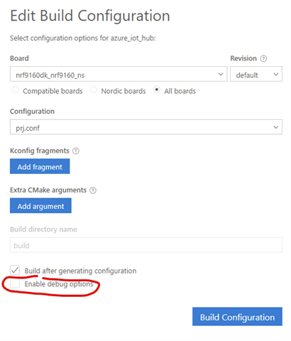

We load the azure_iot_hub project in VS code as active application and we set the Kconfig to
 - use AZURE_IOT_HUB
 - port is 8883
 - TLS sec Tag is 10
 - Azure IoT Hub hostname to our Azur IoT Hub hostname
 - Device ID to our device ID
 - no DPS
We added
CONFIG_LOG=y
CONFIG_AZURE_IOT_HUB_LOG_LEVEL_DBG=y
to our prjconf.
Building the project (for nrf9160dk_nrf9160_ns)
and debugging works fine.

    Based on your hint about stack size, we have doubled the 3 heap and stack sizes (CONFIG_HEAP_MEM_POOL_SIZE, CONFIG_MAIN_STACK_SIZE. and CONFIG_SYSTEM_WORKQUEUE_STACK_SIZE) from 4096 to 8000. This has no effect; the release build still runs fine while the debug build still has error -111.
  • In addition to our last post, we have some more information according the DK version:
    We just received our new 9160-DK that we have ordered to be sure that it is not an DK issue. The new board is a 1.1.0 version.
    We have updated the modem firmware to version 1.3.3, loaded the certificates and builded the Azure_iot_hub sample project.
    And still the same: Release runs fine; debug generates error -111. And still not depending on any stack sizes...
