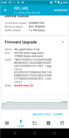

Showing the error state when running dfu to nRF5340
Our product is based on nRF5340 and will run DFU over BLE.
Now I am testing the DFU function via the "Firmware Upgrade" in device manager APP.
In the current architecture, there are two kinds of dfu image should be sent to device:
app_update.bin(app core only) and dfu_application.zip(app_core and net_core).
When updating the dfu_application.zip,  the device can receive the whole image and
do the updating successfully.
The log below shows the image has been swapped to the primary partition.
But the "device manager" still shows an error "Invalid value(3)".

The device manager shows the error:
If I just updated the app_update.bin, all the process is good.

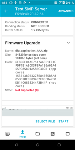

    As I mentioned in my post, I can upgrade our product of app_core and net_core simultaneously.
    So the configuration of bootloader and zephyr shouldn't have any problem.
    I tried the example ( Simultaneous DFU for app and net...) and got the same result.
    ==> nRF connect (Android): PASS
            nRF connect Device Manager(Android) : Upgrading finished. App still show error.
    I am just wondering why the upgrading is successful but the "Device Manager" app still shows error.
    It means the app can't get the right result of device upgrading.

  • Hi Marte,
    I tried the "deselect Erase application settings" but it's not help on the issue.
    I attached the log file from nrf-Logger.
    Thanks.

    V	16:29:20.224	[i] Test response: {"images":[{"image":0,"slot":0,"version":"0.0.0","hash":"G6V5WINRNSardqi77o2ZPBhCBrh9zodaQZPp3vKRGe8=","bootable":true,"pending":false,"confirmed":true,"active":true,"permanent":false},{"image":0,"slot":1,"version":"0.0.0","hash":"WQ8COgsXl1rsMoACcM+JjSwxmhDjyO2EL6spzdZfu/c=","bootable":true,"pending":true,"confirmed":false,"active":false,"permanent":false},{"image":1,"slot":1,"version":"0.0.0","hash":"0fgEISavjGu2dl7n579VCBvihlH8NVZhnoWp8ORpPeo=","bootable":true,"pending":false,"confirmed":false,"active":false,"permanent":false}],"splitStatus":0}
    I	16:29:20.245	[e] Sending (58 bytes) Header (Op: 2, Flags: 0, Len: 50, Group: 1, Seq: 127, Command: 0) CBOR {"confirm":false,"hash":"0fgEISavjGu2dl7n579VCBvihlH8NVZhnoWp8ORpPeo="}
    I	16:29:20.270	[e] Data written to da2e7828-fbce-4e01-ae9e-261174997c48, value: (0x) 02-00-00-32-00-01-7F-00-BF-67-63-6F-6E-66-69-72-6D-F4-64-68-61-73-68-58-20-D1-F8-04-21-26-AF-8C-6B-B6-76-5E-E7-E7-BF-55-08-1B-E2-86-51-FC-35-56-61-9E-85-A9-F0-E4-69-3D-EA-FF
    I	16:29:20.408	[e] Notification received from da2e7828-fbce-4e01-ae9e-261174997c48, value: (0x) 03-00-01-77-00-01-7F-00-BF-66-69-6D-61-67-65-73-9F-BF-65-69-6D-61-67-65-00-64-73-6C-6F-74-00-67-76-65-72-73-69-6F-6E-65-30-2E-30-2E-30-64-68-61-73-68-58-20-1B-A5-79-58-83-51-35-26-AB-76-A8-BB-EE-8D-99-3C-18-42-06-B8-7D-CE-87-5A-41-93-E9-DE-F2-91-19-EF-68-62-6F-6F-74-61-62-6C-65-F5-67-70-65-6E-64-69-6E-67-F4-69-63-6F-6E-66-69-72-6D-65-64-F5-66-61-63-74-69-76-65-F5-69-70-65-72-6D-61-6E-65-6E-74-F4-FF-BF-65-69-6D-61-67-65-00-64-73-6C-6F-74-01-67-76-65-72-73-69-6F-6E-65-30-2E-30-2E-30-64-68-61-73-68-58-20-59-0F-02-3A-0B-17-97-5A-EC-32-80-02-70-CF-89-8D-2C-31-9A-10-E3-C8-ED-84-2F-AB-29-CD-D6-5F-BB-F7-68-62-6F-6F-74-61-62-6C-65-F5-67-70-65-6E-64-69-6E-67-F5-69-63-6F-6E-66-69-72-6D-65-64-F4-66-61-63-74-69-76-65-F4-69-70-65-72-6D-61-6E-65-6E-74-F4-FF-BF-65-69-6D-61-67-65-01-64-73-6C-6F-74-01-67-76-65-72-73-69-6F-6E-65-30-2E-30-2E-30-64-68-61-73-68-58-20-D1-F8-04-21-26-AF-8C-6B-B6-76-5E-E7-E7-BF-55-08-1B-E2-86-51-FC-35-56-61-9E-85-A9-F0-E4-69-3D-EA-68-62-6F-6F-74-61-62-6C-65-F5-67-70-65-6E-64-69-6E-67-F5-69-63-6F-6E-66-69-72-6D-65-64-F4-66-61-63-74-69-76-65-F4-69-70-65-72-6D-61-6E-65-6E-74-F4-FF-FF-6B-73-70-6C-69-74-53-74-61-74-75-73-00-FF
    I	16:29:20.431	[e] Received Header (Op: 3, Flags: 0, Len: 375, Group: 1, Seq: 127, Command: 0) CBOR {"images":[{"image":0,"slot":0,"version":"0.0.0","hash":"G6V5WINRNSardqi77o2ZPBhCBrh9zodaQZPp3vKRGe8=","bootable":true,"pending":false,"confirmed":true,"active":true,"permanent":false},{"image":0,"slot":1,"version":"0.0.0","hash":"WQ8COgsXl1rsMoACcM+JjSwxmhDjyO2EL6spzdZfu/c=","bootable":true,"pending":true,"confirmed":false,"active":false,"permanent":false},{"image":1,"slot":1,"version":"0.0.0","hash":"0fgEISavjGu2dl7n579VCBvihlH8NVZhnoWp8ORpPeo=","bootable":true,"pending":true,"confirmed":false,"active":false,"permanent":false}],"splitStatus":0}
    V	16:29:20.453	[i] Test response: {"images":[{"image":0,"slot":0,"version":"0.0.0","hash":"G6V5WINRNSardqi77o2ZPBhCBrh9zodaQZPp3vKRGe8=","bootable":true,"pending":false,"confirmed":true,"active":true,"permanent":false},{"image":0,"slot":1,"version":"0.0.0","hash":"WQ8COgsXl1rsMoACcM+JjSwxmhDjyO2EL6spzdZfu/c=","bootable":true,"pending":true,"confirmed":false,"active":false,"permanent":false},{"image":1,"slot":1,"version":"0.0.0","hash":"0fgEISavjGu2dl7n579VCBvihlH8NVZhnoWp8ORpPeo=","bootable":true,"pending":true,"confirmed":false,"active":false,"permanent":false}],"splitStatus":0}
    V	16:29:20.469	[j] Moving from state TEST to state RESET
    I	16:29:20.486	[e] Sending (10 bytes) Header (Op: 2, Flags: 0, Len: 2, Group: 0, Seq: 128, Command: 5) CBOR {}
    I	16:29:20.495	[e] Data written to da2e7828-fbce-4e01-ae9e-261174997c48, value: (0x) 02-00-00-02-00-00-80-05-BF-FF
    I	16:29:20.533	[e] Notification received from da2e7828-fbce-4e01-ae9e-261174997c48, value: (0x) 03-00-00-02-00-00-80-05-BF-FF
    I	16:29:20.551	[e] Received Header (Op: 3, Flags: 0, Len: 2, Group: 0, Seq: 128, Command: 5) CBOR {}
    V	16:29:20.570	[g] Reset request success. Waiting for disconnect...
    W	16:29:40.822	[e] Error: (0x8): GATT CONN TIMEOUT
    I	16:29:40.851	[e] Disconnected
    I	16:29:40.878	[g] Device disconnected
    V	16:29:40.895	[g] Waiting remaining 4665 ms for the swap operation to complete
    V	16:29:45.597	[j] Moving from state RESET to state CONFIRM
    I	16:29:49.881	[e] Connected to C1:28:62:08:A0:D8
    I	16:29:50.823	[e] PHY updated (TX: LE 2M, RX: LE 2M)
    I	16:29:51.319	[e] Connection parameters updated (interval: 7.5ms, latency: 0, timeout: 5000ms)
    I	16:29:51.472	[e] Services discovered
    I	16:29:51.530	[e] Connection parameters updated (interval: 45.0ms, latency: 0, timeout: 5000ms)
    I	16:29:51.569	[e] MTU changed to: 498
    I	16:29:51.800	[e] Data written to descr. 00002902-0000-1000-8000-00805f9b34fb, value: (0x) 01-00
    I	16:29:51.830	[e] Notifications enabled
    I	16:29:51.855	[e] Data written to da2e7828-fbce-4e01-ae9e-261174997c48, value: (0x) 00-00-00-01-00-00-FF-06-A0
    I	16:29:52.034	[e] Notification received from da2e7828-fbce-4e01-ae9e-261174997c48, value: (0x) 01-00-00-06-00-00-FF-06-BF-62-72-63-08-FF
    I	16:29:52.064	[e] Received Header (Op: 1, Flags: 0, Len: 6, Group: 0, Seq: 255, Command: 6) CBOR {"rc":8}
    I	16:29:52.096	[e] PHY read (TX: LE 2M, RX: LE 2M)
    I	16:29:52.113	[e] Sending (58 bytes) Header (Op: 2, Flags: 0, Len: 50, Group: 1, Seq: 0, Command: 0) CBOR {"confirm":true,"hash":"WQ8COgsXl1rsMoACcM+JjSwxmhDjyO2EL6spzdZfu/c="}
    I	16:29:52.119	[e] Sending (10 bytes) Header (Op: 0, Flags: 0, Len: 2, Group: 0, Seq: 1, Command: 6) CBOR {}
    I	16:29:52.182	[e] Data written to da2e7828-fbce-4e01-ae9e-261174997c48, value: (0x) 02-00-00-32-00-01-00-00-BF-67-63-6F-6E-66-69-72-6D-F5-64-68-61-73-68-58-20-59-0F-02-3A-0B-17-97-5A-EC-32-80-02-70-CF-89-8D-2C-31-9A-10-E3-C8-ED-84-2F-AB-29-CD-D6-5F-BB-F7-FF
    I	16:29:52.221	[e] Data written to da2e7828-fbce-4e01-ae9e-261174997c48, value: (0x) 00-00-00-02-00-00-01-06-BF-FF
    I	16:29:52.357	[e] Notification received from da2e7828-fbce-4e01-ae9e-261174997c48, value: (0x) 03-00-00-8D-00-01-00-00-BF-66-69-6D-61-67-65-73-9F-BF-65-69-6D-61-67-65-00-64-73-6C-6F-74-00-67-76-65-72-73-69-6F-6E-65-30-2E-30-2E-30-64-68-61-73-68-58-20-59-0F-02-3A-0B-17-97-5A-EC-32-80-02-70-CF-89-8D-2C-31-9A-10-E3-C8-ED-84-2F-AB-29-CD-D6-5F-BB-F7-68-62-6F-6F-74-61-62-6C-65-F5-67-70-65-6E-64-69-6E-67-F4-69-63-6F-6E-66-69-72-6D-65-64-F5-66-61-63-74-69-76-65-F5-69-70-65-72-6D-61-6E-65-6E-74-F4-FF-FF-6B-73-70-6C-69-74-53-74-61-74-75-73-00-FF
    I	16:29:52.383	[e] Received Header (Op: 3, Flags: 0, Len: 141, Group: 1, Seq: 0, Command: 0) CBOR {"images":[{"image":0,"slot":0,"version":"0.0.0","hash":"WQ8COgsXl1rsMoACcM+JjSwxmhDjyO2EL6spzdZfu/c=","bootable":true,"pending":false,"confirmed":true,"active":true,"permanent":false}],"splitStatus":0}
    I	16:29:52.409	[e] Notification received from da2e7828-fbce-4e01-ae9e-261174997c48, value: (0x) 01-00-00-06-00-00-01-06-BF-62-72-63-08-FF
    V	16:29:52.436	[a] Confirm response: {"images":[{"image":0,"slot":0,"version":"0.0.0","hash":"WQ8COgsXl1rsMoACcM+JjSwxmhDjyO2EL6spzdZfu/c=","bootable":true,"pending":false,"confirmed":true,"active":true,"permanent":false}],"splitStatus":0}
    I	16:29:52.468	[e] Received Header (Op: 1, Flags: 0, Len: 6, Group: 0, Seq: 1, Command: 6) CBOR {"rc":8}
    I	16:29:52.497	[e] Sending (58 bytes) Header (Op: 2, Flags: 0, Len: 50, Group: 1, Seq: 2, Command: 0) CBOR {"confirm":true,"hash":"0fgEISavjGu2dl7n579VCBvihlH8NVZhnoWp8ORpPeo="}
    I	16:29:52.522	[e] Data written to da2e7828-fbce-4e01-ae9e-261174997c48, value: (0x) 02-00-00-32-00-01-02-00-BF-67-63-6F-6E-66-69-72-6D-F5-64-68-61-73-68-58-20-D1-F8-04-21-26-AF-8C-6B-B6-76-5E-E7-E7-BF-55-08-1B-E2-86-51-FC-35-56-61-9E-85-A9-F0-E4-69-3D-EA-FF
    I	16:29:52.658	[e] Notification received from da2e7828-fbce-4e01-ae9e-261174997c48, value: (0x) 03-00-00-06-00-01-02-00-BF-62-72-63-03-FF
    I	16:29:52.680	[e] Received Header (Op: 3, Flags: 0, Len: 6, Group: 1, Seq: 2, Command: 0) CBOR {"rc":3}
    E	16:29:52.704	Upgrade failed
    Mcu Mgr Error: IN_VALUE (3)
    	at g2.e$b.c(Unknown Source:24)
    	at h2.f.j(Unknown Source:10)
    	at h2.f.a(Unknown Source:0)
    	at h2.d.run(Unknown Source:4)
    	at android.os.Handler.handleCallback(Handler.java:873)
    	at android.os.Handler.dispatchMessage(Handler.java:99)
    	at android.os.Looper.loop(Looper.java:210)
    	at android.os.HandlerThread.run(HandlerThread.java:65)
    Jacob
  • Hi Jacob,
    The issue is with selecting "Test & Confirm". For multicore uploads you must use "Confirm Only" instead. This is because the network core does not have a way to swap images, so it can only overwrite the existing one. "Test" assumes swapping, verifying and confirming, but also allows restoring the original, which is not possible on the network core.
    "Confirm Only" mode is also faster.
    Marte
