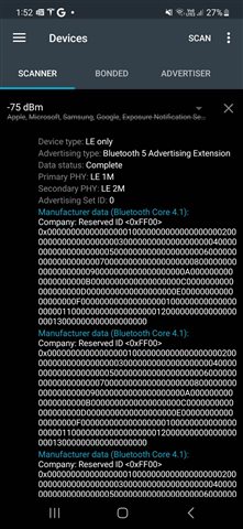

    In the example I added a counter in every 10 bytes to the array. And send the data as 4 200-byte arrays each in one ad struct.
    If you use a phone that support chained advertising you can capture the data as follow:
    Note that the nrf Connect app on the phone is a generic app and is not configure to detect the data handling of 200 bytes chunk. It can detect the data structure simply by following the advertising spec/standard. If you click on RAW data, you can see that it has a 0xC9 byte which is the length (201 bytes) before each data structure and then merge them together and send them via the chained advertising packets which has max 255 bytes size.
    On the receiver side, you can simply follow the spec and use the length byte to parse the advertising data you receive. As you can see it's been done on the phone.
