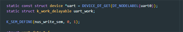

I have not made any major changes to the central_uart sample, as it already implements the UART async api. The device is linked to uart0.
In the mqtt_simple sample I have tried to implement async uart similar to how it is implemented in the central_uart_sample. The init rutine succeeds and so does the uart_tx, but none of the messages are received by the other part.
Here is my UART module, added to the mqtt_simple sample:

static const struct device *uart; // = DEVICE_DT_GET(DT_NODELABEL(uart0));

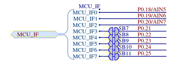

  • To clarify, what happens when I am trying to send a message over UART is that the uart_tx()-function returns successfully, but I do not see anything on the recipient side. This is the case in both directions.
    Also attaching the schematic I have been looking at when deciding the pins to use for RX/TX.
    PCA20035_Schematic_And_PCB.pdf
    From the schematic you link:
    I suggest that you connect an oscilloscope or logic analyzator to SB8 and SB9 and see if you can see any traffic on the actual lines.
    That way you can figure out if the error is in the nRF9160 or nRF52840.
    Also, I recommend having a look at our Asset Tracker v2 and Connectivity bridge samples, as they also do UART communication between the 9160 and 52840 on the Thingy91.
    Sigurd Hellesvik
    Thanks for the answer. I actually just manages to make it work! :)
    The solution was to also configure the CTS and RTS pins in both overlay files. These were set up in the original board files to pins that are not connected in my case. This is probably why there were no data flow on my UART lines. I also changed the uart peripheral to uart1 from uart0. Not sure if this was necessary, but I can test it and report what I find.

    				<NRF_PSEL(UART_CTS, 0, 19)>;
    	uart1_sleep: uart1_sleep {
    		group1 {
    			psels = <NRF_PSEL(UART_TX, 0, 25)>,
    				<NRF_PSEL(UART_RX, 1, 0)>,
    				<NRF_PSEL(UART_RTS, 0, 22)>,
    			low-power-enable;
    thingy91_nrf9160_ns.overlay
    &uart1 {
    	current-speed = <115200>;
    	status = "okay";
    	pinctrl-0 = <&uart1_default>;
    	pinctrl-1 = <&uart1_sleep>;
    &pinctrl {
    	uart1_default: uart1_default {
    		group1 {
    			psels = <NRF_PSEL(UART_TX, 0, 22)>,
    				<NRF_PSEL(UART_RX, 0, 23)>,
    				<NRF_PSEL(UART_RTS, 0, 24)>,
    				<NRF_PSEL(UART_CTS, 0, 25)>;
    		group1 {
    			low-power-enable;
