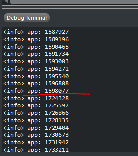

  • Hi, I thought to create a simple test timer in the peripherals/timer example, to eliminate the chance of me doing something strange in my other code.
    So, in the timer example, I added a new timer instance (TIMER_TEST)  with nrf_drv_timer_extended_compare() and I continuously capture and display its internal counter register  inside a while loop to see if the internal counter register is cleared or not after a specified interval.

    The result is the same. The internal counter register value is not cleared after the 100msec (1600000 ticks) interval I have set and the internal register keeps increasing until it overflows. I expect that after 1600000 ticks the value would reset to zero..
    I would expect that the Timer's internal register would be cleared every 1,6M ticks since the interval I have set is 100msec.
    I checked the TIMER1->SHORTS register in the debugger and the corresponding bit seems to be activated.
    I must be doing something wrong here but I don;t know what it is...
    Regarding your initial question, with what setup did you use to see that the counter runs all the way to 0xFFFF FFF?
    If the setup is the same as your follow-up comment, please see that you are using the same Capture Compare channel to monitor the counter value as the one you use to reset/stop the timer.
    Please change your Capture Compare channel either for the monitoring or for the shortcut, and you should see the timer behaves as you would expect.
    Hieu

  • Hi Hieu,
    yes you are absolutely right.  Now I get it!
    Thank you for your help!
