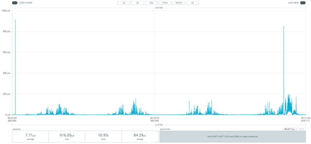

    But in both approaches I don't have a clean graph, I have a noise between the ADC readings, it seems that these noises appear at fixed time intervals, as can be seen below:
    Do you also observe this behavior? Thanks.
  • One explanation might be that you had debugging on while measuring the current. That itself adds a whole lot of static current, and it doesn't go back to normal even when you stop debugging. It goes back when you reset, or re-flash.
    As for the fixed interval noises, if you are not running any other task or peripheral in the background, it could be related to hardware (like a capacitor charging/discharging at intervals, or the regulator misbehaving)
    If you can attach the latest code here, I can have a look at it during my free time.
  • Hi  ,
    It was not due to a debug, but due to a "bug" found in the nRF9160-DK, if the power jumper of the nRF9160 is removed to connect the PPK2 while the DK is with the switch in the ON position, the consumption is with a floor current of 2.8mA.
    After that, even if the DK is restarted, or the device's flash is erased, both by the Programmer and VS Code, none of this solves the problem. The consumption only returns to normal (below 2.8mA) if certain firmware is written. Recording the adc sample firmware did not solve the problem, but if I record at_client, or mqtt_simple (these were the ones I tested, but many others can work) the consumption returns to normal, observing floor currents lower than 3uA. The noises also disappeared!
