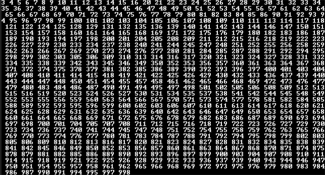

Peripheral_uart passthrough example not fast enough
I'm looking to set up a UART-BLE passthrough for high data rate transmissions (~7500 bytes/s). I've been looking into the peripheral_uart example script but it can't keep up with the transmission speed. I'm sending a count up to 1000 over the RX pin and seeing about half lost on the BLE output. I haven't been able to identify whether the issue is with the UART or BLE.
BLE output on sending 0-1000:
I've removed all of the code relating to BLE security as this is not necessary. I have increased the size of the UART RX buffer. I tried to increase BLE MTU size to 251 in the project config but this is disallowed as its being overwritten somewhere else.
Unfortunately for our particular use, case flow control is not an option.

	int err;
	char addr[BT_ADDR_LE_STR_LEN] = {0};
	bt_addr_le_to_str(bt_conn_get_dst(conn), addr, ARRAY_SIZE(addr));
	LOG_INF("Received data from: %s", addr);
	for (uint16_t pos = 0; pos != len;) {
		struct uart_data_t *tx = k_malloc(sizeof(*tx));
		if (!tx) {
			LOG_WRN("Not able to allocate UART send data buffer");
			return;
		/* Keep the last byte of TX buffer for potential LF char. */
		size_t tx_data_size = sizeof(tx->data) - 1;
		if ((len - pos) > tx_data_size) {
			tx->len = tx_data_size;
		} else {
			tx->len = (len - pos);
		memcpy(tx->data, &data[pos], tx->len);
		pos += tx->len;
		/* Append the LF character when the CR character triggered
		 * transmission from the peer.
		if ((pos == len) && (data[len - 1] == '\r')) {
			tx->data[tx->len] = '\n';
			tx->len++;
		err = uart_tx(uart, tx->data, tx->len, SYS_FOREVER_MS);
		if (err) {
			k_fifo_put(&fifo_uart_tx_data, tx);
// static struct bt_nus_cb nus_cb = {

void ble_write_thread(void)
	/* Don't go any further until BLE is initialized */
	k_sem_take(&ble_init_ok, K_FOREVER);
	for (;;) {
		/* Wait indefinitely for data to be sent over bluetooth */
		struct uart_data_t *buf = k_fifo_get(&fifo_uart_rx_data,
						     K_FOREVER);
		if (bt_nus_send(NULL, buf->data, buf->len)) {
			LOG_WRN("Failed to send data over BLE connection");
		k_free(buf);
K_THREAD_DEFINE(ble_write_thread_id, STACKSIZE, ble_write_thread, NULL, NULL,
		NULL, PRIORITY, 0, 0);

I'm running nRF connect SDK v1.2.0 in VSCode with the nrf52dk built as nrf52810.
Help is much appreciated.
  • Hi Nathalie
    What is the error message you get when trying to increase the MTU size?
    Have you tried to increase the CONFIG_BT_NUS_UART_BUFFER_SIZE setting?
    Could you try to log the length of the packets sent over BLE to see how long packets you are sending?
    I am not sure why you are checking if the length equals 14 in the code, this seems a bit short.
    The peripheral_uart example is not really optimized for speed. I will take a closer look at it next week and see if there is some room for improvement.
    That said, if you are unable to use flow control there will always be some risk of data loss, if the throughput over BLE is lower than the UART throughput.
    Best regards
    Torbjørn
  • Hi Torbjørn,
    This is the error:
    warning: BT_CTLR_DATA_LENGTH_MAX (defined at
    C:/nordicsemi/v2.1.0/nrf\subsys\bluetooth\services\fast_pair/Kconfig.fast_pair:97,
    subsys/bluetooth\controller/Kconfig:380) was assigned the value '251' but got the value '27'. See
    docs.zephyrproject.org/.../kconfig.html and/or look up
    BT_CTLR_DATA_LENGTH_MAX in the menuconfig/guiconfig interface. The Application Development Primer,
    Setting Configuration Values, and Kconfig - Tips and Best Practices sections of the manual might be
    helpful too.
    warning: user value 251 on the int symbol BT_CTLR_DATA_LENGTH_MAX (defined at C:/nordicsemi/v2.1.0/nrf\subsys\bluetooth\services\fast_pair/Kconfig.fast_pair:97, subsys/bluetooth\controller/Kconfig:380) ignored due to being outside the active range ([27, 27]) -- falling back on defaults
    error: Aborting due to Kconfig warnings
    I don't have CONFIG_BT_NUS_UART_BUFFER_SIZE show up as a config option, do I need to import anything for this?
    I'm using 14 as the check because my data is 7 bytes long. Receiving two data points in one packet works better than one, but I'm unable to go up to three because while data is still received on the UART, nothing is received over BLE for a check of 21.
    I am unfortunately unable to use the log as there is not enough SRAM free.
    Do you know of any other examples that would be a better starting point for increased speed?
    Thanks
  • Hi Nathalie
    If you increase CONFIG_BT_BUF_ACL_RX_SIZE as well you should be able to increase the BT_CTLR_DATA_LENGTH_MAX parameter.
    CONFIG_BT_NUS_UART_BUFFER_SIZE should be available if you have copied the peripheral_uart example, it is defined by the Kconfig file in the example root folder.
    You don't have an nRF52DK available for debugging purposes?
    The nRF52810 doesn't come with it's own DK, and normally the nRF52DK is used. This kit uses the nRF52832, which has more available memory.
    In general the best example to start out with if you care about transfer speed is the throughput sample.
    Best regards
    Torbjørn
  • Thanks for the suggestions!
    I ended up writing something from scratch which allowed me to cut out all features not relevant to the application. With this I achieved the required data rate.
