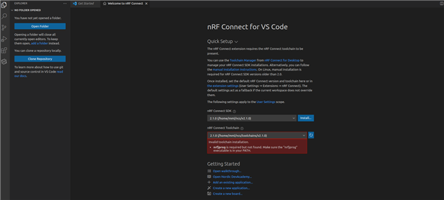

nRF Connect SDK v2.1.1 "Invalid toolchain installation." Error
I installed nRF Connect SDK v2.1.1 on a Ubuntu 22.04 system according to the instructions at "https://academy.nordicsemi.com/topic/exercise-1-1/".
Upon launching VSCode via the Toolchain Manager, I get the following error when I do a "Quick Setup" in the "Welcome to nRF Connect" tab:

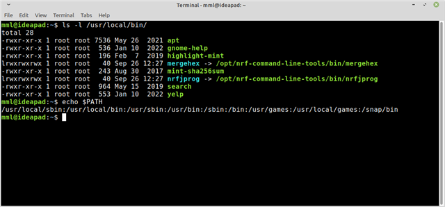

The prompt indicates that nrfjprog needs to be executable in PATH. The problem is, IT IS EXECUTABLE IN PATH:

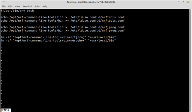

I searched and found Case ID: 293092, which seems to report a similar problem, but the referenced /var/lib/dpkg/info/nrf-command-line-tools.postist file does not look like the one in my system:
After wasting many hours on this, turns out the solution is to download and install the latest Jlink from Segger's website ("https://www.segger.com/downloads/jlink/JLink_Linux_V782_x86_64.deb"). I offer this soltuiotn as a small but I fear fruitless consolation to everyone who has wasted countless hours over this nRF  Connect installer bug, and the infuriatingly stupid and uninformative error message in nRF Connect.

    I am happy to hear that you found the solution to the issue. I have reported the misleading error message to the VS Code extension team.
    After some checking, it turns out installing nRF Command Line Tools triggers install of J-Link Software and Documentation Pack on the other platforms, but not on Ubuntu where it must be installed manually (although the package should be included in the nRF Command Line Tools download.) I have reported this lack of automatic J-Link install to the DevAcademy team. It is definitely our fault for not giving the proper install instructions, and I am sorry for that.

    Yes, this is clearly an error message bug, as in this situation it points in the wrong direction. This is also a documentation bug in DevAcademy and for nRF Command Line Tools, for the Ubuntu target platform, as neither states the requirement of installing the J-Link Software and Documentation Pack.
