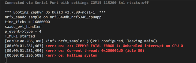

nrfx_timer_extended_compare(&timer0, NRF_TIMER_CC_CHANNEL0, time_ticks, NRF_TIMER_SHORT_COMPARE0_CLEAR_MASK, true);
enable_int parameter is set to true. And for sure the
nrfx_gppi_channel_endpoints_setup
isnt done because only blink LED.
When I set up enable_int to true, than I got the error
Thanks in advance,

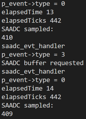

    I mean I want to verify the timestamp between two ADC samples. So time_ADC(n+1) - timeADC(n) = 200uS or whatever defined in SAMPLE_RATE.
    When p_event->type == NRFX_SAADC_EVT_DONE
    if(p_event->type == NRFX_SAADC_EVT_DONE)
    		elapsedTime = k_uptime_get() - prevTime;
    		prevTime = k_uptime_get();
    		printk("elapsedTime %lld\n", elapsedTime);
    		elapsedTicks = k_uptime_ticks() - prevTicks;
    		prevTicks = k_uptime_ticks();
    		printk("elapsedTicks %lld\n", elapsedTicks);
    		//CONFIG_SYS_CLOCK_TICKS_PER_SEC 32768 32.768kHz
    		printk("SAADC sampled: \n");
    		for(uint8_t i = 0; i < p_event->data.done.size; i++)
    			printk("%hi\n", p_event->data.done.p_buffer[i]);
    the buffer is full and it prints out. Okay , but is it possible to see where the buffer is filled with ADC read's, or is this some process in the nrfx_dppi library I can not evaluate the easy way I think.
    Doesn't the program enter the event handler?
    Yes the programm is working like expected, but the timestemp issue described above is untransparent.
    What do you get at the elapsed time?
    not that accurate Disappointed.
    Just to get clear, the event in the event handler is not that important for me. I mean, yes it should not be that much delay after fullfilled when further evaluation takes place. Furthermore interest is in the way the buffer gets fullfiled in considerations of timestep (discretisation).

    I see, you want to verify that the sampling interval is actually 200 µs. From the log output I see that you get elapsed time = 2988 ms which is far from 200 µs. I'm not sure exactly why you're getting that high numbers. I tried pasting your main.c into the saadc.zip that you shared and tried to reproduce your results but got far less values on the elapsed time:
    I expect the elapsed time using this method to be a bit bigger than 200 µs due to the added overhead, but still not as big as 14 ms. At the moment I'm not sure why it returns that high numbers.
    However here is a better suggestion:
     You asked if it was possible to use the DPPI feature to verify the sampling rate. What you can do is to fork the Timer COMPARE event that you use to drive the SAADC to toggle a GPIO by using the GPIOTE peripheral. This means that each time a COMPARE event is generated, it will toggle a GPIO synchronized with starting the SAADC. The interval between each time the GPIO is toggled, is therefore equal to the sampling interval, which means that you can measure the GPIO toggling interval externally to verify the sampling interval.
    Hope this made sense.
    this was my fault! I changed the #define s to
    Though when I change to the #define 200UL buffer 1 sample I get the same
    Uff so its not that simple to get accurate sampling when using ADC from nrf5340 or am I using the wrong code example?
