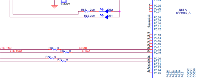

I can't control the nrf9160 with an external mcu.
I connected it to an external mcu as shown below. After downloading serial lte modem to nrf9160,
at command is sent, but it does not respond.  Connect only 3 pins for communication with external MCU (tx, rx, gnd)
rx ------ p0.20
tx ------- p0.19
The settings are as follows.

CONFIG_SLM_CONNECT_UART_2=y
CONFIG_UART_2_NRF_HW_ASYNC_TIMER=2
CONFIG_UART_2_NRF_HW_ASYNC=y
CONFIG_SLM_WAKEUP_PIN=20
CONFIG_SLM_INDICATE_PIN=30

&pinctrl {
    uart2_default_alt: uart2_default_alt {
        group1 {
            psels = <NRF_PSEL(UART_TX, 0, 19)>,
                <NRF_PSEL(UART_RX, 0, 18)>;
                //<NRF_PSEL(UART_RTS, 0, 12)>,
                //<NRF_PSEL(UART_CTS, 0, 13)>;
    uart2_sleep_alt: uart2_sleep_alt {
        group1 {
            low-power-enable;
I checked that the external mcu sends data at 11520bps well, but the nrf9160 does not respond at all.
Can you tell me why?
If you have experience, please advise. thank you.
