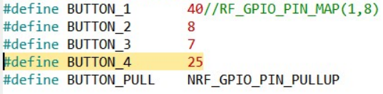

 We are developing mesh project using nrf52833 based on mesh sdk 5.0. First the nrf52833 device can be sucessfully provisioned into a mesh node using mesh lpn example by the nrf mesh app.After powering off the node then power on the device, we found that the provisioned node disappeared.
  Finally the provisioning procedure is done by test nrf52840 device using th same example , we found the the node can also keep the provisoning information after powering down then powering on the device.

Can the nrf52833 keep the provisioning information after power off the device? It seems that there is no provisioning data stored in the nrf52833.
 The datalog for nrf52833 is as below.
 provisioned into a mesh node with a node address(0x000E)
 After powering down the node, the provisioned node disappeared.
