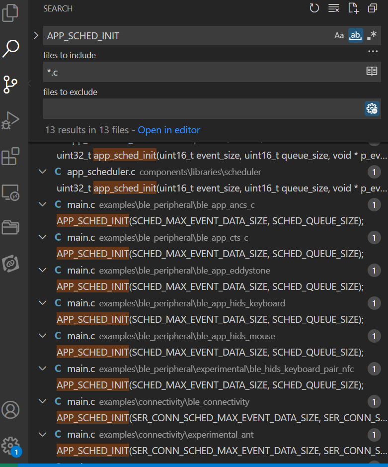

    Please make sure that you have added the app scheduler source files to your project, and enabled the app scheduler in your sdk_config.h:
    // <e> APP_SCHEDULER_ENABLED - app_scheduler - Events scheduler
    #ifndef APP_SCHEDULER_ENABLED
    #define APP_SCHEDULER_ENABLED 1
    Does this resolve your issue?
    Karl
    yes, i've do it,  but got a lot of error.
    and how to connect to  schedule_event_handler()?

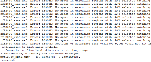

  • Please share the entire error log as text, not a screenshot.
    You may do so by using the Insert -> Code option here on DevZone.
    Karl
  • Hi
    Build started: Project: boex
    *** Using Compiler 'V5.06 update 7 (build 960)', folder: 'C:\Keil_v5\ARM\ARMCC\Bin'
    Build target 'nrf52840_xxaa'
    compiling main.c...
    linking...
    .\_build\nrf52840_xxaa.axf: Error: L6406E: No space in execution regions with .ANY selector matching main.o(.bss).

    .\_build\nrf52840_xxaa.axf: Error: L6406E: No space in execution regions with .ANY selector matching i2c2.o(.data).
    .\_build\nrf52840_xxaa.axf: Error: L6406E: No space in execution regions with .ANY selector matching nrf_drv_power.o(.data).
    .\_build\nrf52840_xxaa.axf: Error: L6406E: No space in execution regions with .ANY selector matching nrf_sdh_ble.o(.data).
    .\_build\nrf52840_xxaa.axf: Error: L6407E: Sections of aggregate size 0x11180c bytes could not fit into .ANY selector(s).
    Not enough information to list image symbols.
    Not enough information to list load addresses in the image map.
    Finished: 2 information, 0 warning and 430 error messages.
    ".\_build\nrf52840_xxaa.axf" - 430 Error(s), 0 Warning(s).
    Target not created.
    Build Time Elapsed:  00:00:25
    if no the line of   APP_SCHED_INIT(1024,1024);  will no error;

    If you go to the definition of APP_SCHED_INIT in app_scheduler.h file, you can see that it defines a static memory array of the size EVENT_SIZE*QUEUE_SIZE.
    In your initialization, you are mentioning that the EVENT_SIZE = 1024 bytes and the QUEUE size for those events is 1024. So the required space for these buffer is atleast 1024 * 1024 bytes. Our chips do not have that much RAM.
    I am not sure why you need an event size of 1024 and a long queue of 1024 items? It seems like you have not understood the concept of it correctly, if that is the case please go through the documentation of the APP_SCHEDULER to understand what an event is and how much memory each event requierd.
    When I search for the use of app_scheduler, I can see that it is being used a lot in our SDK, so you should have several references for it to be able to analyze.
