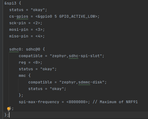

The function disk_access_get_di couldnt find any disk  (returned null) so after some research in this forum and on github we updated our devicetree as following:
NOTE: we had to define sck-pin, mosi-pin and miso-pin in order to make it work.

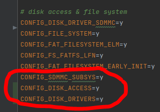

And activated to following additional kConfig:

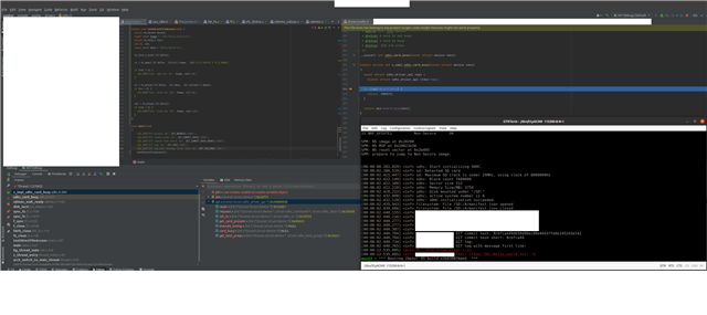

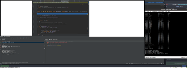

Now, disk_access_get_di found our sd card, but it crashed (immediate reset) at the following line:
SD Card initilization happens during initialization level 'POST_KERNEL'. We had to change this to 'APPLICATION' to make it work...
SYS_INIT(initSdCard, APPLICATION, CONFIG_SDHC_INIT_PRIORITY);
