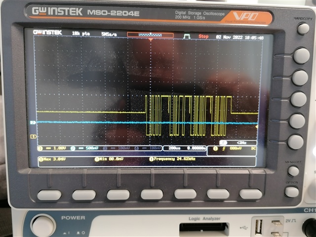

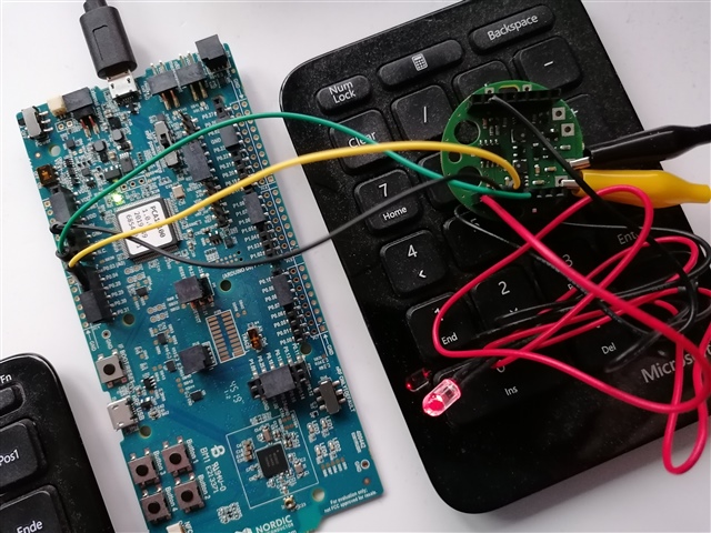

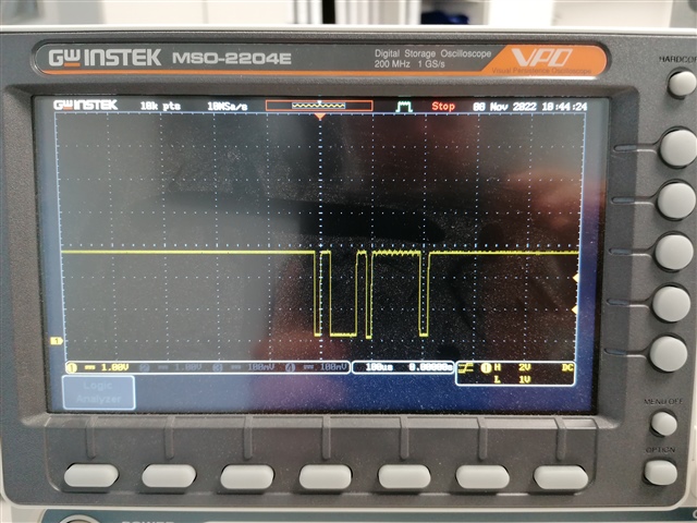

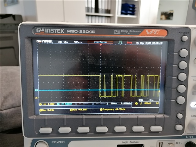

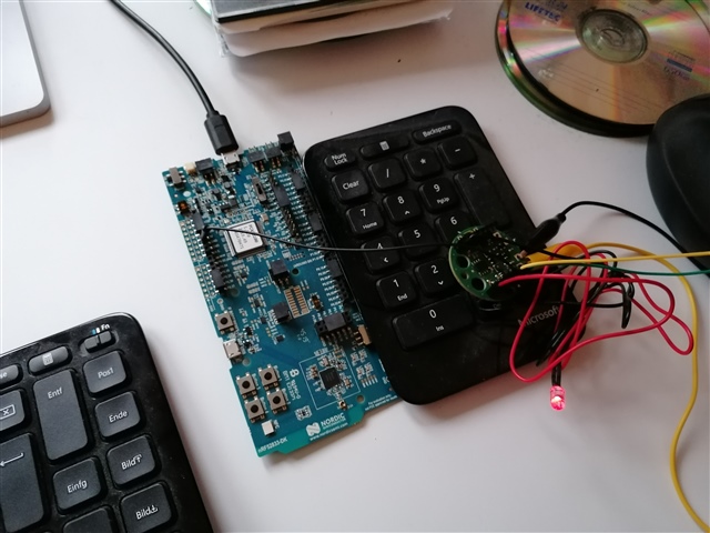

I have the following Problem with the Configuration and Communication over TWI/I2C.
The Voltage of the TWI/I2C Bus is not 3.3V.

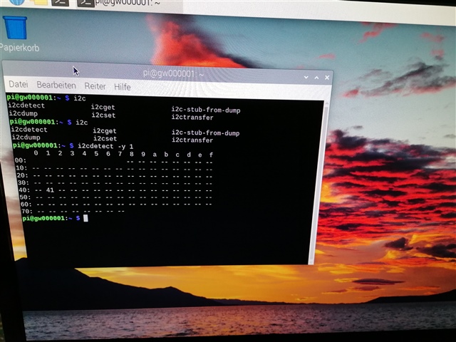

Reference Mesurment with a RPI and ESP32 for the same Sensor Hardware. I can say it's not a hardware fault.
I use as Hardwarebase the nRF52833-DK.
As Development runtime Zephyr with the nRF connect SDK V2.0.0 in Visual Studio Code.

    Ketil asked if I could have a look at this ticket.
    Can you please test the attached application:
    It is configured to use the nRF52833 DK and scan through all I2C addresses. So it is not aware of any particular I2C devices/addresses. Only a basic I2C configuration.
    It should print a lot of errors, but if one or more devices are connected via I2C on the pins (SDA pin P0.03 and SCL pin P0.04), then one of the lines should be an <inf> instead of <err>, and it should say FOUND DEVICE at the end of the line:
    If you can run this test, we can find out whether it is a SW or a HW issue.
    Edvin

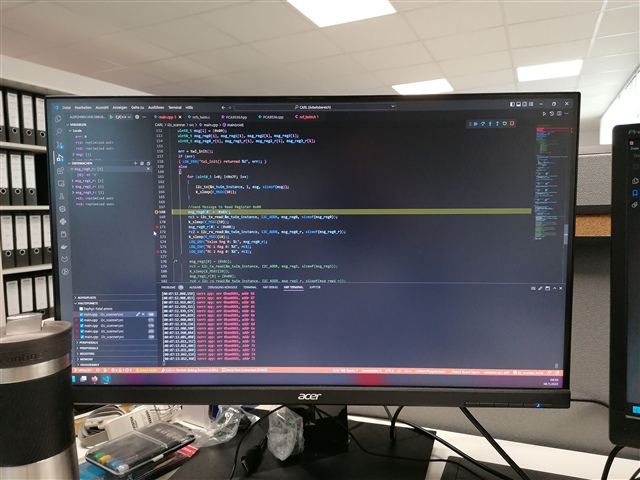

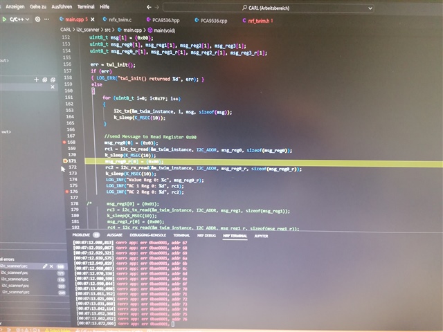

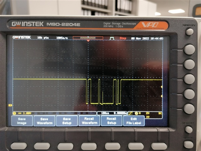

    i run the test and a crosscheck that the I2C-Device is still okey.
    The Log from the i2c-scan program:

    The conection for this test with external Power over 5V by RPI GPIO (PIN2), GND (Pin 6). SCL and SDA conected like our definition
    Crosscheck with rpi:
    SDA and SCL Connectet on RPI GPIO PIN3,5.
    Björn
    Connected via Serial Port with settings COM3 115200 8n1 rtscts:off
    Björn
    aftercross check with the Project Partner, with a little correction of the code change:
    NRFX_TWIM_XFER_DESC_RX
    to
    NRFX_TWIM_XFER_DESC_TX
    shows the Bus clients. (See Log)
    *** Booting Zephyr OS build v3.0.99-ncs1  ***

    [00:00:09.385,498] <inf> app: err 0bad0000, addr 41 FOUND DEVICE

  • Hello Björn,
    So when you are able to write to the device on addr. 0x41, does the voltage look correct on the oscilloscope?
    BR,
    Edvin
  • Hallo Edvin,
    now i get the oscilloscope measurment and now the voltages looks good.
    Programcode write:
    osciloscope
    programcode read:
    osciloscope
    The Read Value of the register 3 of the PCA9536, that is used for write/read, has the value: 255 (0xFF, 0xb1111 1111). This is correct or a not configured PCA9536.
    I have a still question, what is the reason that the manual configured twim work and the automated configuration over the I2C-API don't work.
    I am not sure exactly why it doesn't work, but it suggests that there are some issues in the configuration that you were using.
