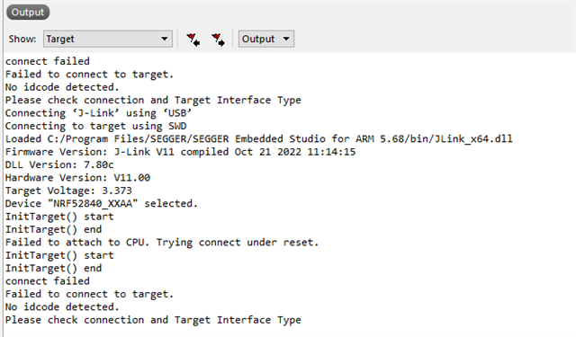

I'm using nrf52840, try to program using Jlink SWD programmer but fessing some issues.
over hardware connections are like below.
When I try to Connect J-Link, I get an error that says "Failed to connect to target. No idcode detected. Please check connection and Target Interface Type".
so could you please tell me this is hardware problem or software problem, if this error solve using software then could you please provide a steps to solve connection error.

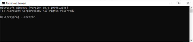

  • i think you are right. its looks like damage during test. But we are using ESD band to remove static.
  • Please find attached log file, if u find any error on it.
    [2023-Apr-25 07:27:40] [debug] --------------------------------------------------------------------------------
    [2023-Apr-25 07:27:40] [debug] nrfjprog --reset --log /home/poulami/Desktop
    [2023-Apr-25 07:27:40] [debug] nrfjprog version 10.21.0 external
    [2023-Apr-25 07:27:40] [ info] Load library at /opt/nrf-command-line-tools/lib/libnrfjprogdll.so.
    [2023-Apr-25 07:27:40] [ info] Library loaded, loading member functions.
    [2023-Apr-25 07:27:40] [ info] Member functions succesfully loaded.
    [2023-Apr-25 07:27:40] [debug] [ Client] - open
    [2023-Apr-25 07:27:40] [debug] [ Client] - start
    [2023-Apr-25 07:27:40] [ info] [ Client] - stdout: Jlinkarm nRF Worker ready. Handling sequence 610d855f-bc09-41fe-9ce8-b5d3aaff5c8f.
    [2023-Apr-25 07:27:40] [debug] [SeggerBackend] - Logger sink registered in Segger backend logger
    [2023-Apr-25 07:27:40] [debug] [  JLink] - Logger sink registered in JLink logger
    [2023-Apr-25 07:27:40] [debug] [  nRFXX] - open
    [2023-Apr-25 07:27:40] [debug] [  nRFXX] - just_check_family
    [2023-Apr-25 07:27:40] [debug] [SeggerBackend] - open_dll
    [2023-Apr-25 07:27:40] [debug] [SeggerBackend] - No J-Link DLL path was provided. Attempting to auto detect.
    [2023-Apr-25 07:27:40] [ info] [SeggerBackend] - Load library at /opt/SEGGER/JLink/libjlinkarm.so.
    [2023-Apr-25 07:27:40] [ info] [SeggerBackend] - Library loaded, loading member functions.
    [2023-Apr-25 07:27:40] [ info] [SeggerBackend] - Member functions succesfully loaded.
    [2023-Apr-25 07:27:40] [debug] [SeggerBackend] - Set batch mode
    [2023-Apr-25 07:27:40] [debug] [SeggerBackend] - dll_version
    [2023-Apr-25 07:27:40] [ info] [SeggerBackend] - Segger dll version 7.86.g loaded.
    [2023-Apr-25 07:27:40] [trace] [ Client] - Command open executed for 11 milliseconds with result 0
    [2023-Apr-25 07:27:40] [debug] [ Client] - config
    [2023-Apr-25 07:27:40] [trace] [ Client] - Command config executed for 2 milliseconds with result 0
    [2023-Apr-25 07:27:40] [debug] [ Client] - enum_emu_snr
    [2023-Apr-25 07:27:40] [trace] [ Worker] - Command open executed for 8 milliseconds with result 0
    [2023-Apr-25 07:27:40] [debug] [  nRFXX] - config
    [2023-Apr-25 07:27:40] [debug] [SeggerBackend] - enum_emu_snr
    [2023-Apr-25 07:27:40] [trace] [ Worker] - Command config executed for 2 milliseconds with result 0
    [2023-Apr-25 07:27:40] [debug] [  nRFXX] - enum_emu_con_info
    [2023-Apr-25 07:27:40] [debug] [SeggerBackend] - is_connected_to_emu
    [2023-Apr-25 07:27:40] [debug] [SeggerBackend] - enum_emu_con_info
    [2023-Apr-25 07:27:41] [trace] [ Client] - Command enum_emu_con_info executed for 818 milliseconds with result 0
    [2023-Apr-25 07:27:41] [debug] [ Client] - connect_to_emu_with_snr
    [2023-Apr-25 07:27:41] [debug] [SeggerBackend] - is_connected_to_emu
    [2023-Apr-25 07:27:41] [trace] [ Worker] - Command enum_emu_con_info executed for 818 milliseconds with result 0
    [2023-Apr-25 07:27:41] [debug] [  nRFXX] - connect_to_emu_with_snr
    [2023-Apr-25 07:27:41] [debug] [SeggerBackend] - connect_to_emu_with_snr
    [2023-Apr-25 07:27:41] [debug] [SeggerBackend] - ---just_enum_emu_snr
    [2023-Apr-25 07:27:41] [debug] [SeggerBackend] - ---just_get_num_emus
    [2023-Apr-25 07:27:43] [debug] [SeggerBackend] - ---just_connect_to_emu_with_snr
    [2023-Apr-25 07:27:44] [debug] [SeggerBackend] - ---just_connect_to_emu_without_snr
    [2023-Apr-25 07:27:44] [debug] [SeggerBackend] - Segger logging enabled.
    [2023-Apr-25 07:27:44] [trace] [  JLink] - Firmware: J-Link OB-SAM3U128-V2-NordicSemi compiled Nov  7 2022 16:21:57
    [2023-Apr-25 07:27:44] [trace] [  JLink] - Hardware: V1.00
    [2023-Apr-25 07:27:44] [trace] [  JLink] - S/N: 683556667
    [2023-Apr-25 07:27:44] [trace] [  JLink] - OEM: SEGGER
    [2023-Apr-25 07:27:44] [trace] [  JLink] - Feature(s): RDI, FlashBP, FlashDL, JFlash, GDB
    [2023-Apr-25 07:27:44] [trace] [  JLink] - USB speed mode: High speed (480 MBit/s)
    [2023-Apr-25 07:27:44] [trace] [  JLink] - TELNET listener socket opened on port 19021
    [2023-Apr-25 07:27:44] [trace] [  JLink] - WEBSRV WEBSRV_Init(): Starting webserver thread(s)
    [2023-Apr-25 07:27:44] [trace] [  JLink] - WEBSRV Webserver running on local port 19080
    [2023-Apr-25 07:27:44] [trace] [  JLink] - - 42.823ms returns "O.K."
    [2023-Apr-25 07:27:44] [trace] [  JLink] - JLINK_HasError()
    [2023-Apr-25 07:27:44] [trace] [  JLink] - JLINK_Lock()
    [2023-Apr-25 07:27:44] [trace] [  JLink] - JLINK_ExecCommand("SetRestartOnClose = 0", ...).
    [2023-Apr-25 07:27:44] [trace] [  JLink] - - 0.003ms returns 0x01
    [2023-Apr-25 07:27:44] [trace] [  JLink] - JLINK_ExecCommand("DisableFlashDL", ...).
    [2023-Apr-25 07:27:44] [trace] [  JLink] - - 0.002ms returns 0x00
    [2023-Apr-25 07:27:44] [trace] [  JLink] - JLINK_ExecCommand("ExcludeFlashCacheRange 0x0-0xFFFFFFFF", ...).
    [2023-Apr-25 07:27:44] [trace] [  JLink] - - 0.001ms returns 0x00
    [2023-Apr-25 07:27:44] [trace] [  JLink] - JLINK_SetHookUnsecureDialog
    [2023-Apr-25 07:27:44] [trace] [  JLink] - JLINK_SetHookUnsecureDialog(...)
    [2023-Apr-25 07:27:44] [trace] [  JLink] - - 0.006ms returns 0
    [2023-Apr-25 07:27:44] [trace] [  JLink] - JLINK_TIF_Select(JLINKARM_TIF_SWD)
    [2023-Apr-25 07:27:44] [trace] [  JLink] - - 6.573ms returns 0x00
    [2023-Apr-25 07:27:44] [trace] [  JLink] - JLINK_GetSpeedInfo()
    [2023-Apr-25 07:27:44] [trace] [  JLink] - 10000000 Hz / n, n >= 10
    [2023-Apr-25 07:27:44] [debug] [SeggerBackend] - Connected emulator supports SWD speeds up to 1000kHz
    [2023-Apr-25 07:27:44] [debug] [SeggerBackend] - Requested speed 2000kHz is higher than the emulator max speed of 1000kHz
    [2023-Apr-25 07:27:44] [trace] [  JLink] - JLINK_SetSpeed(2000)
    [2023-Apr-25 07:27:44] [trace] [  JLink] - - 2.018ms
    [2023-Apr-25 07:27:44] [trace] [  JLink] - JLINK_GetSpeed()
    [2023-Apr-25 07:27:44] [trace] [  JLink] - - 0.003ms returns 1000
    [2023-Apr-25 07:27:44] [debug] [SeggerBackend] - SWD speed was reported as 1000kHz after requesting 2000kHz. Check the capabilities of the selected emulator.
    [2023-Apr-25 07:27:44] [trace] [  JLink] - JLINK_GetSN()
    [2023-Apr-25 07:27:44] [trace] [  JLink] - - 0.003ms returns 683556667
    [2023-Apr-25 07:27:44] [trace] [  JLink] - - 0.004ms
    [2023-Apr-25 07:27:44] [debug] [  nRFXX] - read_device_family
    [2023-Apr-25 07:27:44] [debug] [SeggerBackend] - is_connected_to_emu
    [2023-Apr-25 07:27:44] [trace] [  JLink] - JLINK_IsOpen()
    [2023-Apr-25 07:27:44] [debug] [SeggerBackend] - read_debug_port_idr
    [2023-Apr-25 07:27:44] [debug] [SeggerBackend] - read_debug_port_register
    [2023-Apr-25 07:27:44] [debug] [SeggerBackend] - ---just_read_debug_port_register
    [2023-Apr-25 07:27:44] [debug] [SeggerBackend] - coresight_configure
    [2023-Apr-25 07:27:44] [trace] [  JLink] - JLINK_GetHWStatus(...)
    [2023-Apr-25 07:27:44] [trace] [  JLink] - - 2.044ms returns 0
    [2023-Apr-25 07:27:44] [trace] [  JLink] - JLINK_CORESIGHT_Configure()
    [2023-Apr-25 07:27:44] [trace] [  JLink] - - 102.577ms returns 0
    [2023-Apr-25 07:27:44] [debug] [SeggerBackend] - ---just_select_debug_port_register
    [2023-Apr-25 07:27:44] [debug] [SeggerBackend] - Select AP 255, DP Bank 0, AP Bank 255
    [2023-Apr-25 07:27:44] [trace] [  JLink] - JLINK_CORESIGHT_WriteAPDPReg(DP reg 0x02, 0x00000000)
    [2023-Apr-25 07:27:44] [trace] [  JLink] - - 2.256ms returns -1
    [2023-Apr-25 07:27:44] [debug] [SeggerBackend] - ---just_abort_debug_action
    [2023-Apr-25 07:27:44] [debug] [SeggerBackend] - Attempting to clear any configuration errors in debug port before closing connection.
    [2023-Apr-25 07:27:44] [trace] [  JLink] - JLINK_CORESIGHT_WriteAPDPReg(DP reg 0x00, 0x0000001F)
    [2023-Apr-25 07:27:44] [trace] [  JLink] - - 2.008ms returns -1
    [2023-Apr-25 07:27:44] [trace] [  JLink] - - 3.060ms returns -1
    [2023-Apr-25 07:27:44] [trace] [  JLink] - - 2.814ms returns -1
    [2023-Apr-25 07:27:44] [trace] [  JLink] - - 1.989ms returns -1
    [2023-Apr-25 07:27:44] [trace] [  JLink] - - 1.984ms returns -1
    [2023-Apr-25 07:27:44] [trace] [  JLink] - - 2.023ms returns -1
    [2023-Apr-25 07:27:44] [trace] [  JLink] - - 1.943ms returns -1
