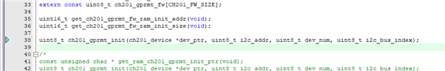

When I compile the code, it gives me error like that method is not defined yet before. But you can check at my header, I call that method from it's file (but the code is not defined at header, but I just make the code works on it is source file).
Below is the code when I compile it without defining it on header file.
..\..\..\main.c(95): error:  #20: identifier "ch201_gprmt_init" is undefined
  	chirp_error |= ch201_init(&sensor, &CH201_SENSOR_FW_INIT_FUNC);
So I was planning to define it on header library. But, when I define it on header library, it gives me more errors message than before.
So as you can check in the picture below, now I define it and looks like no errors on it.
But, when I compile, it gives me more errors (4 errors). It is said the ch201_device is not defined, but I define it at my main library code. Below is the error result.
..\..\..\..\..\..\components\libraries\ch201\ch201_gprmt.h(38): error:  #20: identifier "ch201_device" is undefined
  uint8_t ch201_gprmt_init(ch201_device *dev_ptr, uint8_t i2c_addr, uint8_t dev_num, uint8_t i2c_bus_index);
So Is there any solution for this? Thank you for your appreciation.
