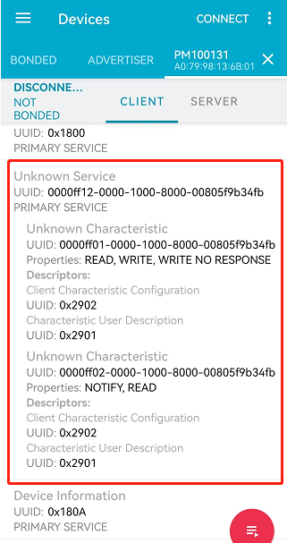

nRF52833 cannot interconnect and communicate with BLE chip of Realtek
Our customer has a project that uses nrf52833 as the master and want to connect to the slave of portable ECG meter (ble is Realtek). But they tried for a long time and still failed.
1. ECG meter (slave device) --- Realtek ble device Information :
UUID types: 128bit
UUID = {0xFB, 0x34, 0x9B, 0x5F, 0x80, 0x00, 0x00, 0x80, 0x00, 0x10, 0x00, 0x00, 0x00, 0x00, 0x00, 0x00}
2. nrf52833 DK as master device:
a. BLE central base on "nRF5_SDK_17.1.0_ddde560\examples\ble_central\ble_app_uart_c\pca10100\s122\arm5_no_packs"
b. Scan filter for UUIDs and UUID config is below:
#define NUS_BASE_UUID {{0xFB, 0x34, 0x9B, 0x5F, 0x80, 0x00, 0x00, 0x80, 0x00, 0x10, 0x00, 0x00, 0x00, 0x00, 0x00, 0x00}}   /**< Used vendor-specific UUID. */
#define BLE_UUID_NUS_SERVICE    0xFF12                                              /**< The UUID of the Nordic UART Service. */
#define BLE_UUID_NUS_RX_CHARACTERISTIC     0xFF01                      /**< The UUID of the RX Characteristic. */
#define BLE_UUID_NUS_TX_CHARACTERISTIC      0xFF02                      /**< The UUID of the TX Characteristic. */
c. If  "#define NUS_SERVICE_UUID_TYPE   BLE_UUID_TYPE_BLE", 52833 can be connected to ECG meter, but the service cannot be found that log is "Service UUID 0xFF12 not found.".
    If  "#define NUS_SERVICE_UUID_TYPE   BLE_UUID_TYPE_VENDOR_BEGIN" , 52833 cannot connect to ECG meter and the function of ble_advdata_uuid_find() return 7 (NRF_ERROR_INVALID_PARAM). This function is called by adv_uuid_compare() in the file "nrf_ble_scan.c".

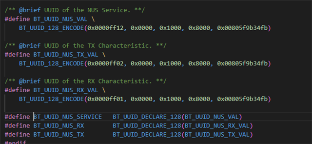

    UUID types: 128bit
    This is not a vendor defined 128-bit UUID, this is the base UUID used by the 16-bit UUIDs defined by Bluetooth SIG.
    0xFF12
    I can't find 0xFF12 in the Assigned Numbers document here, https://www.bluetooth.com/specifications/assigned-numbers/ , so it's seems like they have not registered it with the Bluetooth SIG...

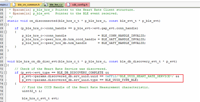

  • Hi sigurd,
    The service (0xFF12) cannot be found after modifying according to your suggestions. The attachment is the output log.
    Pany

  • Hi Sigurd,
    Sorry for the late reply. The attachment is the main.c .
    BR
    Pany
