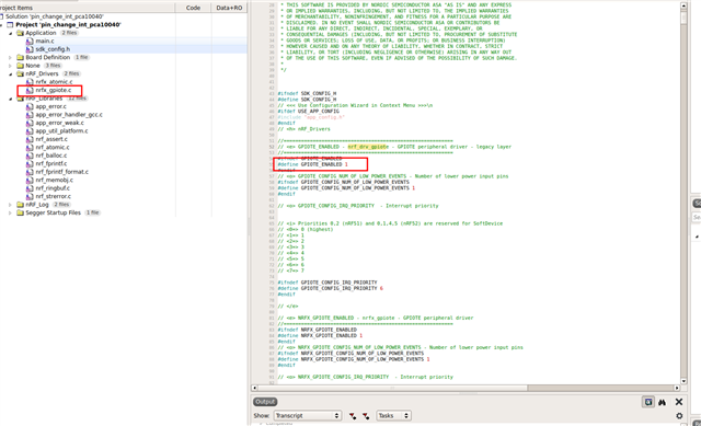

Hi, I was creating a new project that uses interrupt. I start from TWI Examples and implement interrupt on it.
So when I implement the interrupt method, I got this error below.
.\_build\nrf52811_xxaa.axf: Error: L6218E: Undefined symbol nrfx_gpiote_in_event_enable (referred from ch201.o).
.\_build\nrf52811_xxaa.axf: Error: L6218E: Undefined symbol nrfx_gpiote_in_init (referred from ch201.o).
.\_build\nrf52811_xxaa.axf: Error: L6218E: Undefined symbol nrfx_gpiote_init (referred from ch201.o).
.\_build\nrf52811_xxaa.axf: Error: L6218E: Undefined symbol nrfx_gpiote_out_init (referred from ch201.o).
.\_build\nrf52811_xxaa.axf: Error: L6218E: Undefined symbol nrfx_gpiote_out_toggle (referred from ch201.o).
So, I was thinking maybe that's because in SDK Config, the interrupt is not enabled. But when I look for enabling interrupt on sdk,. I can't find anything on that. Anybody have solution for this? Thank you.
