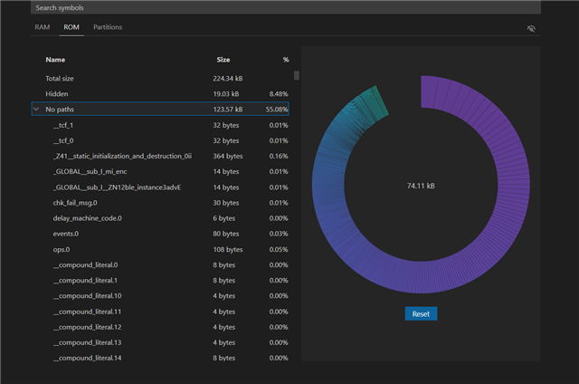

Hello everybody,
I am doing some optimizations on the code due to I am at 94% of used of the ROM (I am using DFU).
When I created the memory report, I realized that there is a part called No Path that demads more than a half of the rom.
My questions are:
1. What does No Path refer to?
2. Is it possible to reduce its size?
Thank you in advace for your help.
Leonardo Santa
  • Hi Leonardo,
    Could you share a picture of the same after expanding the dropdown option for No Paths?
    Best Regards,
    Priyanka
  • Hi dear Priyanka,
    As you will see in the image, there are a lot of small files.
  • Hi Leonardo,
    This does seem to take a lot of memory. Could you let me know which sample/application you have used so that I can try to replicate this?
    -Priyanka
  • Hi Priyanka,
    I took the example from  Add DFU support to your application and I added some modifications.
    I have also realized that when I add some lines at the prj.conf the No Path memory usage increased drastically:
    1. CONFIG_MCUMGR_SMP_BT=y increases around 62kb the flash usage in the No Paths memory report.
    2.CONFIG_BT_CENTRAL=y increases around 45kb the flash usage in the No Paths memory report.

  • Hi Lonardo,
    I have reported this internally and will let you know as soon as I get a response.
    -Priyanka
