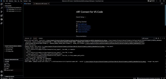

    I tried using the "Memory Report" tool, but it failed:
    The same error appears using both v2.0.2 and v2.1.0
    Not sure what "drive" the error is referring to...    Does it require that the tools be on the same volume as the project?
    Thanks again...
    Yes, this seems to be an issue caused by ntpath.py. I found that this issue has recently been reported internally, but it is a Zephyr issue and not something that can be fixed in the VS Code extension. It has been reported to Zephyr here: https://github.com/zephyrproject-rtos/zephyr/issues/51549, so if you want to follow the development you can look there.
    One thing you can try is to move your project, or make a copy of it, on the same drive as your nRF Connect SDK installation.
