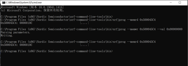

Now we don't add the external capacitance and want to change the  internal capacitance . I have install the test tool and send the command to write the register,but it seems fail ,how to write it succesfully?

    We just want to use the J-Link tool to modify the capacitors to find the appropriate value . We don't make the power cycle when we do the test.Now I had install the 'nrf-command-line-tools' .If we want to set the internal capacitors to be 0, which command could use? And waht is the test step?
    Looking forward the reply~Thanks.
  • Is there any application flashed to the chip?
    Try to recover both the network and application cores, and then write to the XOSC32MCAPS register.
    The network core must be recovered first using:
    nrfjprog --coprocessor CP_NETWORK --recover
    And then the application core can be recovered using:
    nrfjprog --recover
    Do you want to disable the capacitors? Setting the register to 0 will disable them. If you want to set the capacitance to the lowest value you must write 0x100 to the register.
    You are using the correct command for writing to the register.
