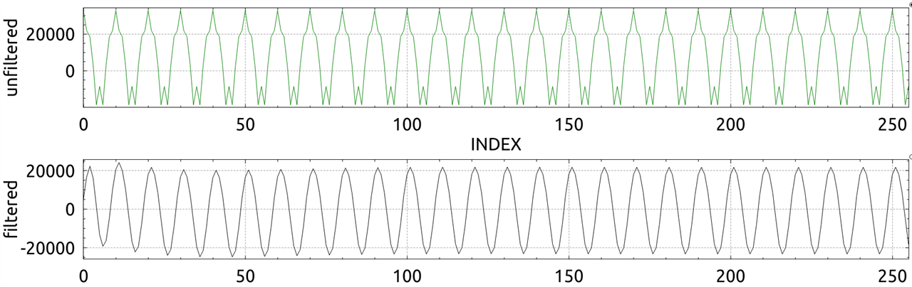

My question is: How can the Butterworth filter cancel out the noises and only select the band of desirable frequency for my project. Does it work only on frequency generated by the electrical voltage Or it can also filter the BITS value in the memory?
Thanks in advance.
    according to the example.c on the github page that you linked it should work like this:
    1. you create a filter with the desired parameters like this:
    BWBandPass* filter = create_bw_band_pass_filter(4, 250, 2, 45);
    (in this example it would be a 4th order band pass filter with a sampling rate of 250 Hz with a frequency band of 2 ... 45 Hz)
    2. assuming you have one buffer for the unfiltered data from the ADC (let's call that buffer "unfiltered") and one buffer to store the filtered data in (called "filtered"), and both are SAMPLE_BUFFER_LEN long, you can apply the filter to the data like this:
    for(int i = 0; i < SAMPLE_BUFFER_LEN; i++){
       filtered[i] = bw_band_pass(filter, unfiltered[i]);
    3. when you are done with filtering you can dispose of the filter with:
    free_bw_band_pass(filter);
    4. Now the "filtered" array will contain the resulting signal, without noise.
    I tried the filter above with a synthetic test signal that contains a 25Hz sine wave with some 100 Hz noise and a DC offset. The result looks like this: (upper half is the original signal with distortions, lower half is the output of the filter)
    As you can see, the noise and the DC offset is gone in the filtered signal, so the filter seems to be doing what it's supposed to do.
    Best regards
    Frank

    I think you will have to contact the author for the filter you are using.
    But since the filter seems to be only a software filter then there is some computation here that will change the digital values, and not the analog values. So the filter that you are pointing to is not a physical filter that effects the voltage level or frequency of the incoming signal before it is translated to digital values and stored in the memory.
