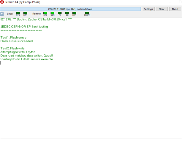

    I don't quite agree on this. Testing the spi_flash example on the nRF52840 I'm able to reproduce your same issue "SPI flash driver MX25R64 was not found". I had to add CONFIG_FLASH =y to the nrf52840dk_nrf52840.conf file for it work, even though it was already added to the prj.conf file. It seems that the project will ignore the prj.conf file if the board.conf file is included. At this point I'm not 100% sure if this is a bug from our side. But, I therefore suspected that your issue is really with the spi_flash example and not BLE related.
    Either way,
    I tried merging the two examples myself and made sure that the both CONFIG_FLASH=y and CONFIG_NORDIC_QSPI_NOR=y was enabled in the prj.config file. It solved the issue:
    Can you double check that both of these are set in your .config file in your build folder?
    Here is my merged project:
    7838.peripheral_uart.7z
    regards
