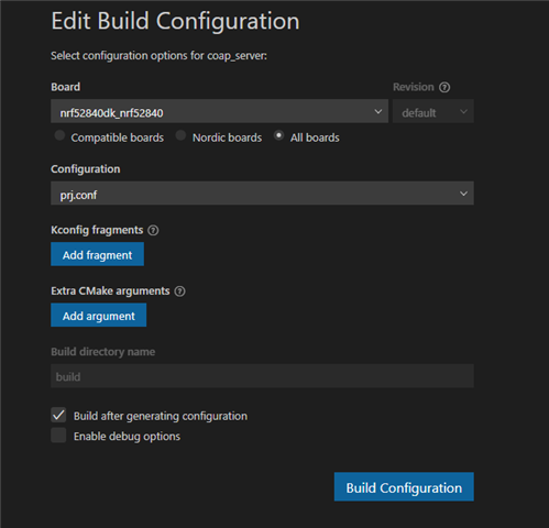

Just build standard example for openthread , like coap_sever.
Application rebooted after openthread are fully started

    Thank you for the update. It works fine when you just run an example without debugging, but when you start j-tag debugger it crashes.
    Step to reproduce:
     1. Start the debugger with j-tag link
     2. Set breakpoint on light_request_handler
     3 Debug step-by-step
     4. Crash happens
    Volodymyr.
