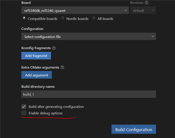

 I create a application based on 802154_phy_test template.
When I create a configuration and build for the nRF52840 it compiles OK.
When I create a configuration (without the cpunet fragment) and build for the nRF5340 network MCU it does not compile because it cannot find the radio driver includes.
If I create a configuration with the cpunet fragment it says it cannot fit the application in flash
